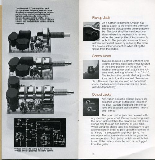

Great info. Does any one know where I can find a diagram for the pickup. Seems like there is a lead not soldered. The main white wire coming out of the bottom of the pickup is good, but then there is a post with some solder on bottm of pick up, but no wire. Would this be just a ground wire?

Not sure if this will help, it's from my owners manual for my '79 1612, hopefully you can magnify the print and find what you're looking for.

Thank you very much. Every little bit of info helps!
