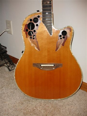

I recently inherited a 1987 Ovation Collector's series. It was sitting in my mom's closet since 2000 w/o strings. I took it to get some strings put in at a local music store only to be told that the fingerboard needed repairing. Since I don't play guitar, I would like to sell. If you are interested, please email me and I can send you pictures. It's a beautiful guitar. It comes with the Ovation hard case.

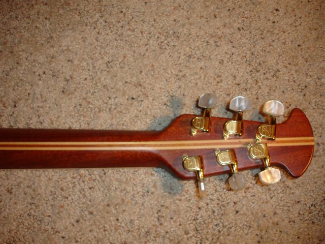

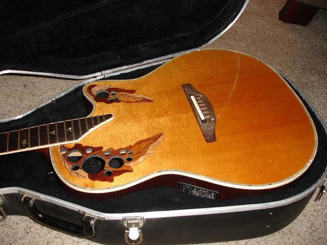

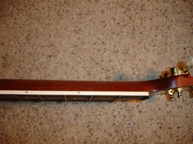

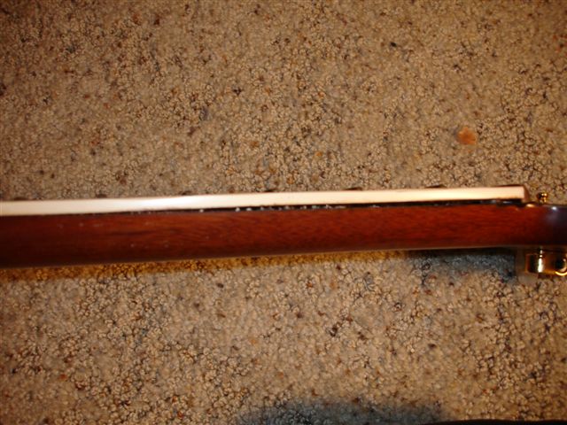

Paul, he sent me some pictures that I'll try to post if I get time tonight. The fretboard on the high E side is lifting, separating from the neck. I've never seen that before. I thought that if his dad bought it new, the factory might fix it under warranty.

Posted 2006-02-02 11:58 PM (#331135 - in reply to #331129)
Subject: Re: 1987 Collector's Series
Posts: 1673

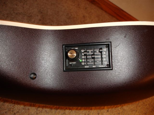

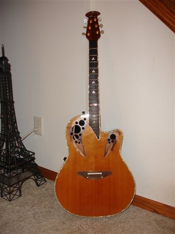

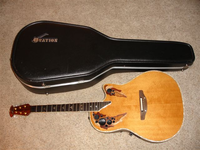

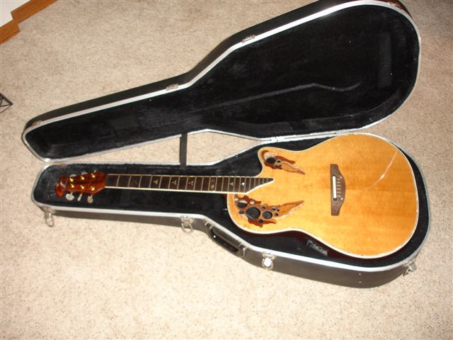

Here you go...
noah
Posted 2006-02-03 12:02 AM (#331136 - in reply to #331129)
Posts: 1673
and here are the rest...
Tim in Tidewater
Posted 2006-02-03 12:29 AM (#331137 - in reply to #331129)
December 2005
Posts: 1234
Just an observation...but, no strings and either temperature or lack of tension caused the neck to pull away from the fretboard? Isn't the tension of the bar always pulling the neck away from the strings to keep the neck straight?
tdeej
Posted 2006-02-03 12:45 AM (#331138 - in reply to #331129)
Posts: 286
Location: North Idaho
A convincing example to never remove all the strings for any length of time without releasing rod tension. Is it just the abalone and binding or the ebony as well?
Edit: still a great looking instrument. awesome bridge
Posted 2006-02-03 12:51 AM (#331139 - in reply to #331129)
Whatever the reason, looks like an expensive trip to the factory. Maybe a replacement neck. Maybe they could repair the neck they took off Moody's.
Course, maybe a little CyA and wood screws would work :eek:
In all seriousness, this could be a VERY expensive project.
noah
Posted 2006-02-03 3:00 AM (#331140 - in reply to #331129)
Posts: 1673
If it got to the Mothership...
Wouldn't they be able to release the tension, pull the neck and glue/clamp the fretboard back down. There does not appear to be any other issues.
We all know how great Factory neck resets are when we get them back. The guys in CT do this stuff in their sleep.
