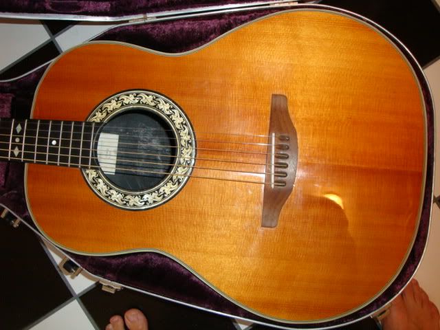

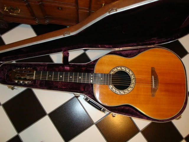

Hi again,
The shop owner let me take the guitar for a few days and gave me a set of steel strings (11's)to put on to see how I like it.
Here is a pic of the label:
And a few others:
But here's the rub. Putting the steel strings on changed what I thought was a finish crack into what I think is more structural. Is this a common issue with Ovations?:
I also notice the fretboard takes a bit of a downward slant after the 12 fret.
Any thoughts?
Bob

If I have the story straight...
If you remove the truss rod cover and strings, it may come to your attention that there is very little wood at that area where the neck and headstock take a turn. I believe in later years the angle was straightened out some to come up with a stronger area there. Other than that it's quite a find. Would be worth a call to John or Kim to see what they would do about it.

The finish cracks are common on the old slot heads, but if it opens up when you tighten the strings, it could be a serious problem that would decrease the value. Whether you buy it depends on you. A model with the Josh White stencil is probably worth a bit more, I'd guess $50-100 more, than the next guitar produced without the Josh White name, but a 1971 is not going to be worth more than one from later in the 70s. Check on sales of old Folklores on this site and ebay and see how they compare. I'd guess $400 on the low end if there aren't any finish cracks on the body and the neck crack is just in the finish.
