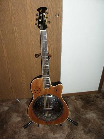

The latest creation from the more-guts-than-brains ShadeTree Luthier laboratory. It started life as an Applesauce 3/4-size. Well, so much for that incarnation, anyway:

Chris, looks like fun. Is this on the block?

Well, Deev, not quite yet. I need to tweak a few things, and let all the parts settle in awhile. Actually, it has good intonation. It's somewhat akin to a "leap-of-faith" when cutting out the top, setting the cone, and gluing the whole mess together. Pretty easy to get the geometry "out of kilter".
I may attempt to amplify the critter, too. I have a couple of preamps laying around, and may trundle myself down to the local Radio Shack for a couple of piezo sensors.

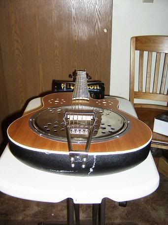

Y'know, James, I was curious myself. Looking at the piece, and it's relative age, I think it's WAY older than that. Actually, I had to paste on an expansion ring, so it was wide enough to span the soundwell, and still attach to the top. I'm thinking it was made for a cone less than the 9 1/2" one that I used. That would be unusual, indeed.

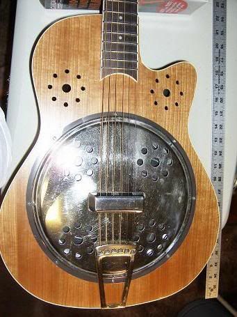

Well, traditionally, biscuit-bridge for verticals, and spiders for horizontals.
There's a guy in Canada selling kits for about $75.00 USD, either type.
The trick is getting the scale & saddle-break right.
You're going to have to put a soundwell into the top, so that may fix the concavity issue, anyway.

id go with a 9 1/2in cone,biscuit bridge.....its not hard to make a soundwell....

Actually, the sunken top is not a terminal issue. You just need to calculate for the drop, when installing the soundwell.
With Ovations, I've found that putting a larger & deeper endblock into the bottom is pretty crucial, since you have to secure the tailpiece down there.
