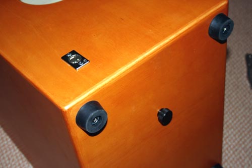

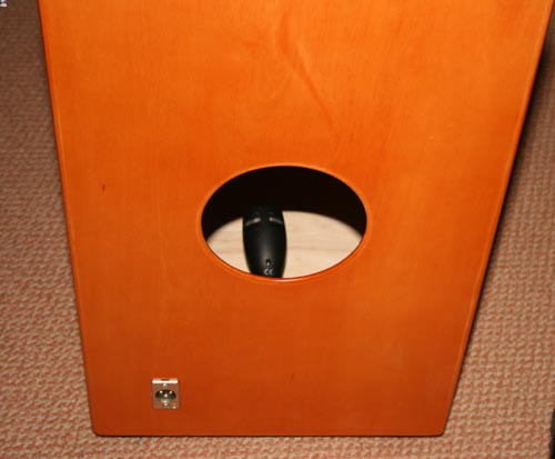

For those of you who bought Cajons from Al and microphones from me, just thought I'd share this neat little internal microphone instalation.
Remove the thumbscrew/bolt from the microphone clamp and drill a hole in the base of the cajon. The mike now screws directly to this. Get hold of a male XLR chassis plug and mount it in the back of the cajon. Take a short length of microphone cable and solder a female XLR line socket to it, soldering the other end to the chassis plug.
The entire job took me less than 20 mins. I'm not really sure if it's worth the effort but it looks tidier and saves all of 45 seconds of set-up time at a gig!
Incidentaly, I have 1 of these mikes left and that's it, I can't get any more. So if you need one now's your last chance. $65 plus shiping

GreatIdea!!!
When we had this set up for "th'Vic", Paul installed two mics into it, the one in the pic for the "kick", and a smaller, condensor mic for the "slap" of the snare (and each mic was eq'd correspondingly) . . .
Thru a PAIR of Bose units, it sounded KILLAH!!!!!

Paul, the cajon idea is brilliant.

Well I finally did the microphone upgrade.
Actually put two jacks in (one on each back corner) so that I could run dual mics for low and high frequencies if I decide I want to down the road.
Did a few minutes of recording....FANTASTIC!
Thanks again for the great idea Paul and for those of you with that extra bit of Christmas cash still laying around............
