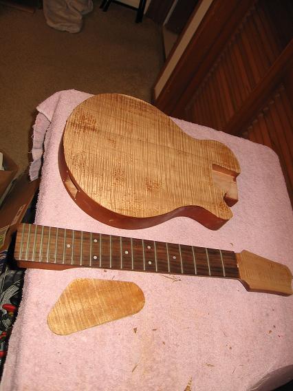

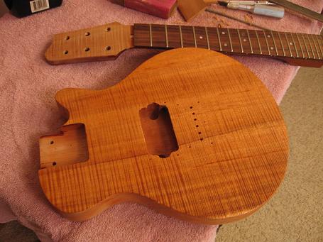

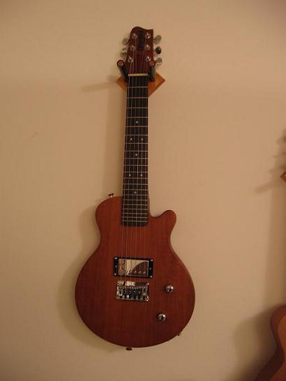

Take one of those Olympia solidbody A scale electrics with the Volume/distortion controls and have some fun with it.
Original:
In Progress
http://www.ovationfanclub.com/photos/MWoody_32636_Glued%20and%20cut...
More to follow...
TRboy
Posted 2006-08-28 3:15 PM (#242720 - in reply to #242719)
Subject: Re: Non-O Project Papoose
February 2003
Posts: 2178
Good Work,Woody.......Is the hardware gold or chrome?
Posted 2006-08-28 3:24 PM (#242721 - in reply to #242719)
Today, its chrome.
This solidbody was a stained piece of Asian Mahogany with dents and such. I just put some Koa veneer over the faces.
I am trying to work up the courage to try my hand at an inlaid binding. We'll see.

Posted 2006-08-28 5:19 PM (#242724 - in reply to #242719)
"What electronics are you putting in?"
Early on I gutted the original stuff and kept the Duncan Design HB103. This time I intend to wire it Volume only.
Possibly add a Ghost System piezos later.

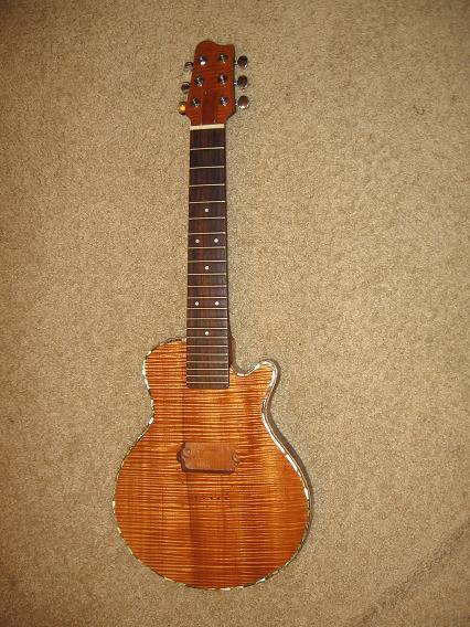

Posted 2006-09-17 8:23 PM (#242727 - in reply to #242719)
Mov'in along...
tdeej
Posted 2006-09-17 8:56 PM (#242728 - in reply to #242719)
Posts: 286
Location: North Idaho
Looking nice. The abalone really perks up on a small body.

Posted 2006-09-17 9:36 PM (#242730 - in reply to #242719)
Notice that I'm keeping a distance - no close ups.
I am still a hack. There were more than a few little mistakes on this one but nothing ventured nothing gained. Finish is poof canned.
Binding then final buff.

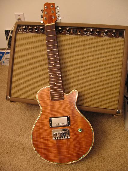

Posted 2006-09-21 12:40 AM (#242731 - in reply to #242719)
Guess who needs to buy strings?
Lack of planning, aye.

Posted 2006-09-21 10:13 AM (#242733 - in reply to #242719)
Posts: 4389
Wow! Looks beautiful. Does it play or feel or sound any different with the new wood?
Posted 2006-09-21 10:30 AM (#242734 - in reply to #242719)
I should put strings on tonight!
I don't expect any changes except that I put on a real Tacoma Papoose neck instead of the Olympia ( think USA Ovation vs. Applause).
When I lined the necks up I saw where the frets were not placed the same. I had intonation issued with the first neck.
