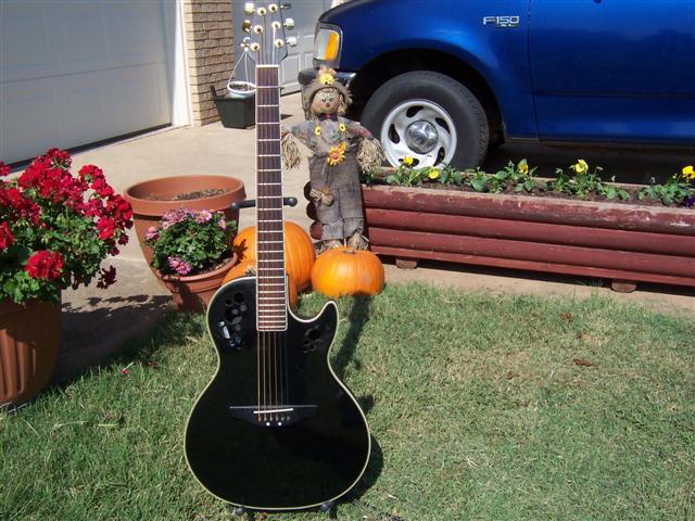

xnoel
Posted 2006-10-31 9:06 PM (#233832 - in reply to #233817)
Subject: Re: Removing epaulets...
Posts: 782
Location: Waurika OK
I took them off my CV68 because I just don't care for them. It was a black top and looked fine when it was done.
I have since taken the entire top off that guitar and have purchased two matched pieces of redwood for a new top. Hot weather caused me to put that project on hold until cooler weather, which has arrived.
I do have some pics of the guitar after the removal, since I have never posted a picture here, all I can do is email pics.
noel

...It must be pretty tough :eek: 'cause I've been trying for about 10 mins to upload a picture that Noel sent me of his viper. I've uploaded the image (4 times) and each time it gives me a url but when I go to my gallery the picture is not there and when I try to post it to this thread,nothing happens.... :confused:
Everybody check their galleries and see if you can find my four missing pics and I'll try again! (They gotta be SOMEWHERE!! )
TRboy
Posted 2006-10-31 10:45 PM (#233835 - in reply to #233817)
February 2003
Posts: 2178
Well the IMAGE linking thingy ain't workin' but HERE's the picture Noel sent me of his Viper....
http://www.ovationfanclub.com/photos/Trboy_81371_xnoel\'s%20viper.j...
.....Looks COOL doesn't it?
