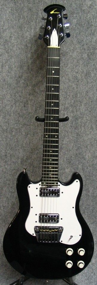

Did someone say T.V. Jones pickups?
The Tuxedo
I put some in a Preacher that someone had (poorly) put regular humbuckers in.
