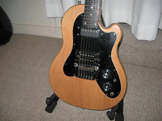

I have a Preacher that has an intonation problem. I took it in to get adjusted, and still have the same problem. So, I am going solo on this trying to figure it out on my own.
The problem "seems" to be with the B string, but it could be with the nut. I just don't know. Does anyone know of a complete walk-thru for a newbie?

Hey Jeff welcome!!
What bridge does it have?
AJ

I'm not sure. How can I tell? I know it is the newer version of the Preacher. It is a six string and chrome. It does not have the word PREACHER engraved in the pick guard. And, the bridge is the full chrome type. It does not have that extra plastic piece on the end. And, the word OVATION is molded into the metal where that plastic piece would be. You can see the word OVATION only when you look at the guitar while looking from the bridge to the neck. If I took some pictures, would that help?
AussieJames
Posted 2008-11-01 12:23 AM (#14024 - in reply to #14021)
Subject: Re: Preacher intonation & setup
June 2007
Posts: 3084
Location: Brisbane Australia
Thats the later all metal Schaller bridge
Like this.
I assume the strings are new?

Well, I didn't get to editing them, so the images are all large. I figure you may be able to see something in the large that I don't know is important. No, the strings were new when I took it in to get setup. I mean, I paid for new strings to be put on which were put on. The guitar sounded the same as it did when I took it in, so I left it in the box until today when I figure I would just do it myself. I managed to break the first string though.
Here are the images, and if they are too large just let me know. I'll reformat them. All of the images I uploaded are between 2MB and 3MB.
In the photos, you'll notice where I adjusted G and B pretty far. I went both ways on B and the intonation didn't sound any different to me. On each adjustment I retuned the guitar. I even marked the fret while bending the string to gauge the difference. That probably doesn't make sense. I also took the pick guard off so that I could get the bridge in my hands to do that way out adjustment. I am sure the pickups look crooked. I don't know how to adjust them either.

Adjusting the saddles that much has to make a difference.
What brand and gauge of strings?
Are you checking the intonation with a tuner or by ear?

A good tuner helps a lot. Do some web searches for "guitar setup" and "Guitar intonation". There are some excellent tutorials out there.
First you'll want to get the basic setup correct. Meaning, the bridge height set properly and the truss rod adjusted. Don't be scared of adjusting the truss rod, just be sure to go slowly. Something like 1/4 turn maximum, then wait a day to see how it settles in. If the truss rod is already pretty close to correct, it will take very small adjustments, like 1/8 turn or less.
After you get the basic setup correct, tune the guitar and adjust the intonation on each string. The 12th fret note should be precisely 1 octave higher than the open string. This is where the electronic tuner helps. Play the open string and make sure it is exactly in tune. Then play the 12th fret note (lightly fretted, not mashed down to where the note is bent) and see if it is exactly in tune but one octave higher. Adjust the bridge nearer the nut if the note is flat, further if it is sharp. Then retune the open string and start over.
If you don't have a good electronic tuner you'll have to do it by ear. You can play the harmonic on the 12th fret by lightly touching the string at the 12th fret, then compare that to the fretted note at the 12th fret. They should be the same note. However, it is not easy to be sure the notes are the same, and the harmonics are not precisely the right note. You should be able to get close this way but it is not as easy as using an electronic tuner.
FlySig
Posted 2008-11-03 10:12 AM (#14034 - in reply to #14021)
Posts: 4081
Location: Utah
For the basic setup, you'll want to get the truss rod adjusted first. Use a capo placed between the 13th and 14th fret, and another between the nut and the 1st fret. You can use your hands but capos make it a lot easier! Now, see how much space there is between the 6th fret and the bottom of the low E string. Also look at the space between the 6th fret and the high E string. Both should be very close but not touching.
If you gently press on the string you should feel it tap the fret. If it is already touching the fret you won't feel the tap.
There are numbers published for what this gap "should" be. I've found that for fast action the gap should just be perceptible. That is, you feel the tap on the fret but can't see significant space there. If you play an aggressive style you will want more space (more relief).
If there is too much relief, too much space, tighten the truss rod with the hex wrench. If there is no space at all, loosen the truss rod. Righty tighty, lefty loosey. Try a 1/8 turn and see what the change is. If you need more adjustment, try another 1/8 turn. If it still needs more, wait until tomorrow to start again.
Once you have the neck adjusted, use the height adjustment on the bridge to set the height of the strings above the 14th fret. It isn't magic which fret you reference. The truss rod adjusts the relief but only acts in the first 12 frets approximately. From there to the 24th fret there is no truss rod effect. When you adjust the height of the bridge you are adjusting the height of the strings across the tops of the 12th to 24th frets. Higher gives less fret buzz, lower is easier and faster action. Search on "Gibson setup specs" for a place to start on how high to set the action.
Changing the height of the bridge will affect the intonation. So set the action up before you do the intonation.
