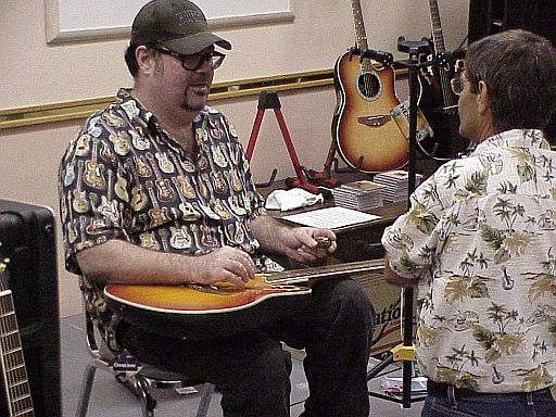

Joined: December 2002 Posts: 939 Location: Fort Worth, Texas | When I went to Matt Smith's Chop Shop he played a modified Ovation guitar lap steel style. I want to say the only modification was to raise the bridge and nut - here's a picture I took, but it's hard to tell about the modification. He played this "Hawaiian steel" type song on it. Unfortunatley we don't get "Mountain Stage" here in N. Texas..... ![]() | ||
