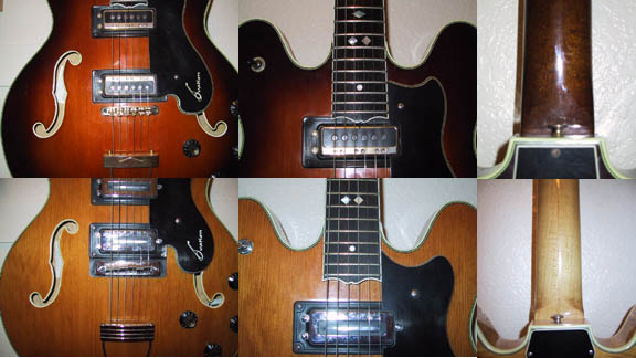

Here's a pic of the difference in the necks
http://www.ovationfanclub.com/photos/moodypi_70276_thunderheadnecks.jpg
Originally, Ovation used the shorter necks (the one on the left, but from 1972 until the end of the Storms in 1974, they went to the longer necks (on the right). This extended the neck further from the body and gave the player more frets to work with. You can see that to compensate, the bridge was moved closer to the bridge pickup.

Boy Paul, those guitars sure look familiar (ha ha). I'm glad you had the picture. I couldn't find a copy on my computer.
Tony, I think the cover screws are #2 philister (?). It's a sometimes called a phillips oval head. It's the same screw as the truss rod covers. As far as finish, I don't know, but it sure is think. Some of them check like hell, others stay perfectly new looking. I can't really find any explanation for it. Here's a hint if you have trouble with the neck angle. On one of mine, the set screw was digging straight into the wood of the neck, so I just stuck a dime in there to give it something solid to force against. Worked perfectly. If you have the snap on cover that goes over the saddle area you may want to put it on ebay. Someone sold one once for $60.
