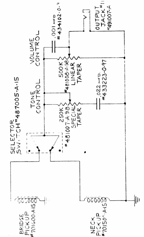

As you can see the electronics are fairly straight forward. As for the bridge; there were two different types.
1) three point mount, required a hole going though the guitar body. This is the Ovation made version.
2) two point mount, guitar body does not have hole through body. All metal version made by Schaller.
You need to make sure that you get the bridge mounting studs with the bridge: the Ovation and Schaller bridges require different ones.
Note that you CAN put a Schaller bridge on a body with the though-hole, you just have to plug the hole. Ovation used a metal stud on early versions with the Schaller bridge.
The bridges were used on the Breadwinner, Deacon, Preacher, Viper, Viper III, UK II & Breadwinner Limited.
BruDeV
Posted 2004-05-03 5:14 PM (#188788 - in reply to #188782)
Subject: Re: Ovation Viper
January 2003
Posts: 1498
Maybe these will help.
