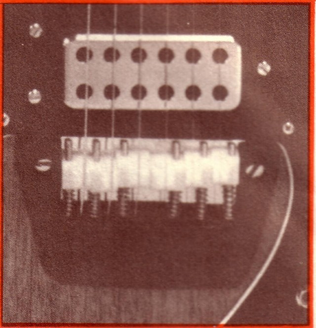

And now I have another question for Viper owners...I put my bridge back together, but the saddles don't want to sit flat on the bridge. I thought maybe they'd settle down once I got it strung up...no such luck. And I notice that the gap between D and G (in the very middle) is wider over the saddles than it is over the nut...the spacing between strings is, of course, fairly consistent at the nut, and betwee 1-2, 2-3, 4-5, 5-6, but between 3-4 it's wider.
I put the saddles back in the way I took them out. I'll attempt some ASCII art:
/ /neck that way
[] [] [ ] [ ] [] [] <--- saddles
| | | | | | \___ saddle screws
end pin here
The widest two saddles in the middle, the taller of the narrow saddles next, the shorter of the narrow saddles on the outside.
Is this right? Why would the distance between 3-4 strings be so much greater at the bridge than the nut...unless something is amiss in my rebuild. I am not happy.

I usually do it 1,3,2,4,5,6. But no big deal.
I would lubricate the height adjustment screws before re-assembling. I use teflon gel, but anything that doesn't migrate will work. Also if you put some sponge-rubber under the back of the bridge it's less of a PITA to change strings (if you do all of them at once).
Usually before installing the strings, I set the height of the bridge so that the top of the plate is even with the top of the pickguard and eyeball the back screw for being parrallel. Most of the time that's is fairly close to the right height.
Also there should be a ground clip that goes on the parrallel screw.

Check on the ground clip...the spring thing is nifty, noticed that when I did the tear down. :) I did the bridge height the same way you suggested. I was somewhat surprised that it didn't rotate forward much when the strings were brought up, but then again, that piece from the back isn't letting it go anywhere.
The big question is, do you mean:
1-3-2-4-5-6
as in skinny/low, fat, skinny/high, fat, skinny/high, skinny/low for the saddles? I didn't trim the strings down (they're just a set of D'Addario XLs I had laying around anyway, so they're not permanent) so I can pull them out and swap the saddles without problem. I think...
Thanks for the answers and help, though!

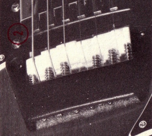

Here's a couple of pictures of the bridge:
http://www.ovationfanclub.com/photos/BruDev_75460_viper%20bridge.jpg
http://www.ovationfanclub.com/photos/BruDev_75782_viper%20bridge%201.jpg
