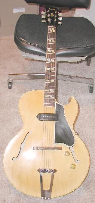

1953 archtop Gibson ES175
Posted 2005-01-02 1:34 AM (#167617 - in reply to #167614)
Subject: Re: arch top vs. ??
showoff... :p
very nice...

Yep, that says "archtop" pretty nicely..... :)

Most archtops have two main braces running down the top. The quintad had 5 in roughly the same pattern but the top was flat.
Nice 53 by the way.
