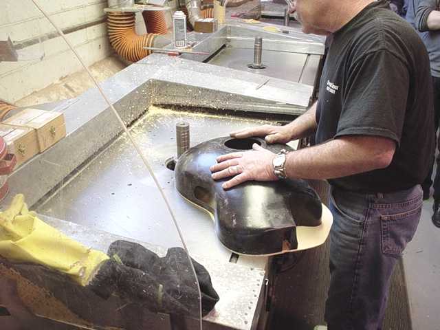

First off you had to glue a "rim" onto the bowl (like kerfing on a wood box guitar) so the top has something to stick to!
Gluing the rim
The "web" connector is cut away leaving just the rim.

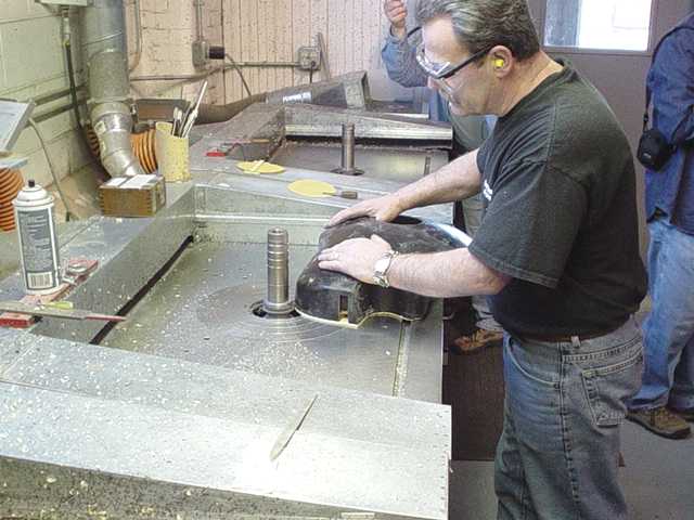

Next (I don't have a pic) a bead of super duper extra strengh (top secret) high bonding goop (not as strong as the duct tape but...) is spread on the rim and then the top is stuck to it and it's set aside to dry (cure) then....
The top is then taken to a couple large router/shaper table where a trim bit/cutter cuts away the excess top and then cuts the rabbet for the binding!
Trimming the edge
More trimming
The second router/shaper is where the rabbet is cut!
It'll all make sense if the make the tour this year but if you can't I hope this helps....
