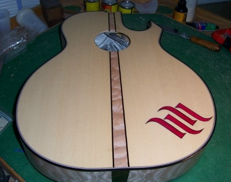

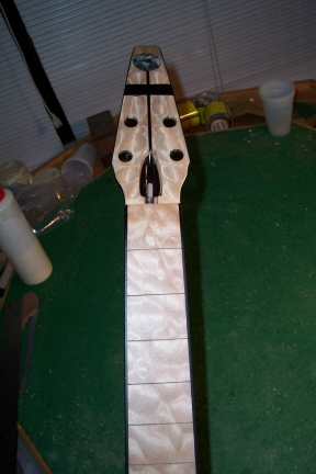

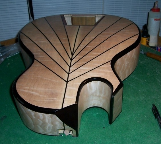

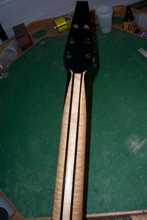

Just wanted to share photos of a guitar I am building.. Its for Hart + Huntington Tattoo company.. The Show on A+E called INKED... Dont mind the mess--- I build my guitars on a poker table .. hahahahaha

OH by the way I am still waiting for the INLAYS so i cant finish it.
Posted 2005-11-29 5:18 PM (#272206 - in reply to #272109)
Subject: Re: Building a guitar
That's going to be one bright flam'in geetar!
Sweet!
Posted 2005-11-29 5:22 PM (#272207 - in reply to #272109)
Nice cutaway! :D
TRboy
Posted 2005-11-29 5:27 PM (#272208 - in reply to #272109)
February 2003
Posts: 2178
LOOKIN' GOOOOD!!!! :eek: :cool:
Couple of questions.......How are you mounting the neck and what's the cutout in the back fer?
