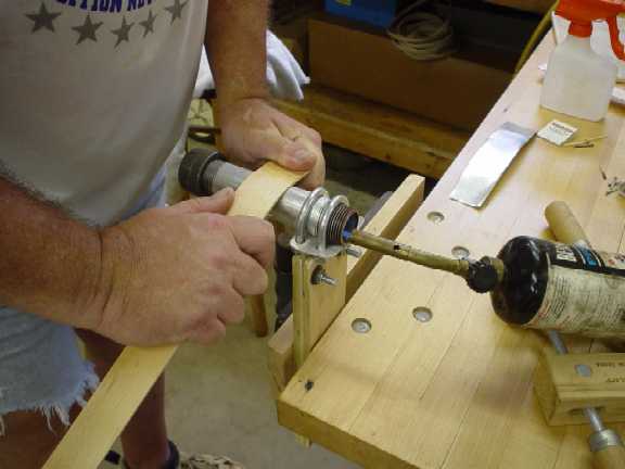

| TRboy |
Joined: February 2003 Posts: 2178 Location: the BIG Metropolis of TR | Do it like a dis...... ;) ![]() | ||
| Jeff W. |
Joined: November 2003 Posts: 11039 Location: Earth·SolarSystem·LocalInterstellarCloud·Local Bub | Thanks, Trboy and Luthier444 (aka L'4s) L'4s, Funny you mentioned rowboats. 20(+) years ago, a colleague and I were the very young, very commited and somewhat talented repair dudes for the historic (70-100+ year old) Chesapeake Bay vessels at the school where we were teaching. We occassionaly used the steam box of a generous local wooden boat builder in Chestertown Md. Bending wood seemed like we were performing magic... I've read about ways to bend the sides of a guitar but, need to hear and I really value you guys offering your advice!! Currently... I'm only in the tonewood-materials-aquisition-phase presently. Once the woods arrive I will begin, in ernest, the design, then processes. There is much research to do and again I thank you for posting! The question I am thinking about tonight is Bridge type... I am inclined to use a pinless bridge and bone saddle. Pinned bridges are attractive for break angle of the strings, but pinned bridge needs a more massive bridge block. A pinless bridge doesn't have as sharp a beak angle, but doesn't need a massive bridge block. Bracing discussions to follow... Thanks again | ||
| luthier444 |
Joined: March 2002 Posts: 255 | Keep in mind the stress of the strings on pin bridges are under the top. Pinless bridges are as strong as the bond of the bridge to the top.. Meaning a pin bridge may not delaminate even if it is lifting from bad glue bond. Pinless bridges , if it delaminates may or may not smack you in the head while you are playing.. There is more to this than that.... Sound wise it is known that , even beyond what may seem lodgical---- You need more bracing to get the low end out of a guitar... { JIMI HENDRIX - PUSHING HIS STRAT AGAINST A CHAIR TO GET MORE VOLUME} The Bass side of a bridge on a hand made guitar is always bigger and thicker then the treble side.. Thats why I dont use either one of them!!!!!!! | ||
