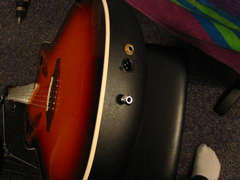

Ok, I did it.
My still slightly stunned thanks to Kim Keller at the Mothership for the wiring harness.
After 45 minutes of praying, measuring, praying, checking, praying, marking, praying, then doing it all over again and again, I took my DeWalt cordless drill in hand and put a 7/8" hole in my 6778LX.
Someone was watching out for me. It wasn't my wife, because she refused to be in the same room, something about, "If you make a mistake and I'm in here, you'll blame me!!".
Anyway, the hole was perfect, the unit fit great, the harness plugged in (bauerhillboy - no problem with the can, although I did have to remove it to plug the harness in).
The signal is definitely hotter than the 1/4". Also cleaner, and I was pleased to hear how clean at church yesterday (I run through a 100' snake to the board). And yes you can run them both at the same time. Phantom power also worked great, using the correct (pin 1 to ground) XLR cable.
All in all I'm very happy with the install.
Thanks again to Kim K. :D You'll get that Diet Coke next month!

Mike, on mine I had noticed an unused jack on the can (on the inside of the guitar) marked "XLR", so I didn't need to change out anything. There is only one jack on the actual preamp, everything is split out in the can. This may be why bauerhillboy was told he needed to replace the can, if he has one that for some reason does not have the XLR jack.
The wiring harness Kim sent me has a board with both an XLR and 1/4" jacks on it. (This is what made the 7/8" hole placement so nerve-racking - it has to align with the existing 1/4" hole...) A ribbon cable runs from the board, plugs into the can.
Sorry for the fuzzy picture - it didn't occur to me to take a picture of it until I had it in and strangely, autofocus don't work so well inside a guitar body... I'll try to get a picture of the can as well.

I see one MAJOR problem!!!
Take a look at yours above.
Now look at my C778LX.
YOU PUT THE XLR ON THE WRONG SIDE OF THE 1/4 PLUG!!!
OH THE AGONY! What are you going to do now that you messed that up? Can't blame your wife. Were your kids anywhere nearby??? :p
Posted 2005-05-24 6:27 AM (#150471 - in reply to #150448)
Subject: Re: OP-Pro question
Y'know, I wondered when someone was gonna say something about that.
The jacks are mounted on the board at a slight angle to each other. I looked at it for about 15 minutes, trying to determine which direction fit the angle best. Then I came to the exhilarating realization that I didn't really care.
But thanks for pointing it out.
Come to think of it, my wife had the TV on kinda loud. And my daughter was in the next room.
I guess now mine is youkneak.
