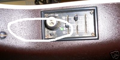

Any chance you could post a pic to show me what you are talking about? I don't understand where the hole will be. Isn't the can for the op-pro bigger than the hole for the fet3? If so, why would there be a hole left over? Wouldn't the current hole, need to be made larger?

DHL - The OpPro is contoured to fit the curve of the body and sits in the deepest part of the curve. The FET is rectangular and at least on mine, sits on a flat spot to the right of the curve. While the holes would overlap, there would be a significant portion of the old hole remaining uncovered.

The upgrade that I did for Glenn involved replacing a single knob preamp - so only two small hole to worry about - one of which was covered by the oppro, the other was capped with a black plug.
The white oval in the picture shows where the OpPro would have to go (approximately). That whole part of the FET-3 not covered by the white oval would be a gaping hole that would have to be filled.
