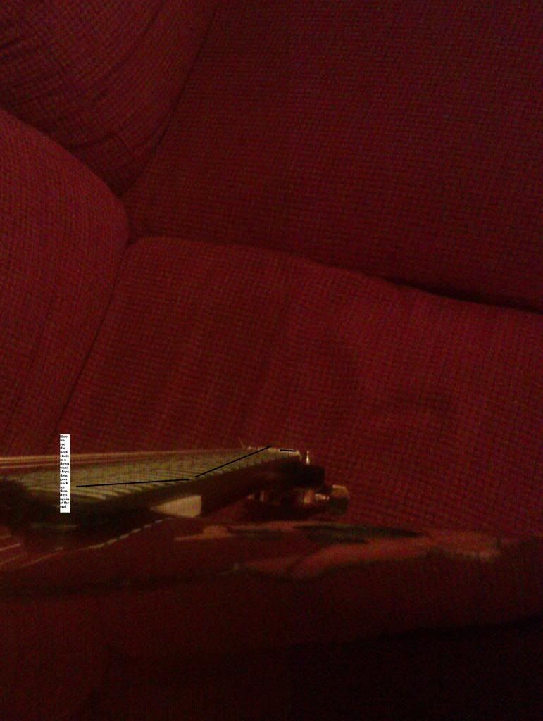

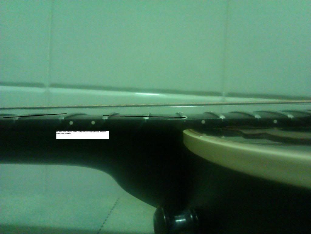

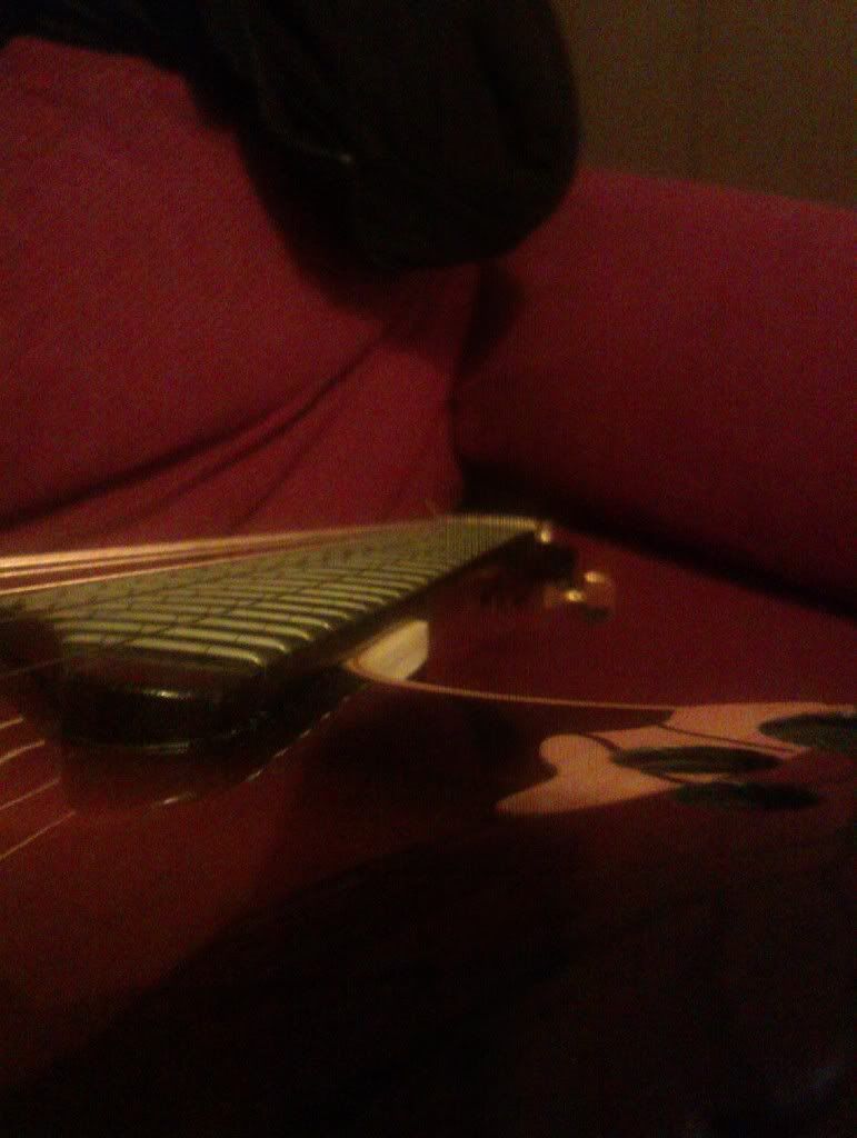

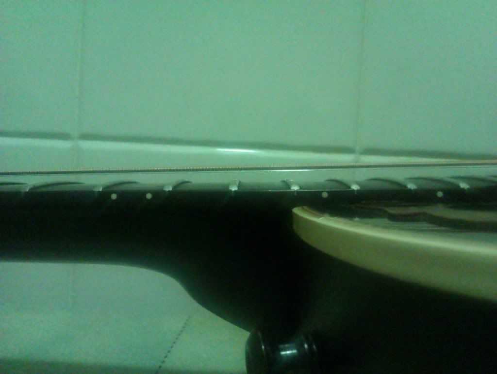

martinez
Posted 2011-12-10 3:28 PM (#345814 - in reply to #345793)
Subject: Re: :-(
September 2011
Posts: 260
Location: Spain
Ok, here goes..I've tried to do the same pic. One without any lines then with lines to show what I mean..haha not sure if this will work..
bburg
Posted 2011-12-10 3:32 PM (#345815 - in reply to #345793)
Subject: Re: :-(
August 2009
Posts: 1137
Hi Craig, you are writing the neck is bent like a snake, so I think the rod is ruffianly overstrung. I'd do the following: loosen the strings, loosen the truss rod completely, store the guitar away for maybe two weeks in a well climated room so the wood can get off the stress.
Then tune her up slowly and look for the neck is still bent in two directions. If so you have bad luck, if not you can clockwise try to adjust the truss rod to the correct setup.
And I keep my fingers crossed for you.....
Bernie
bburg
Posted 2011-12-10 3:43 PM (#345816 - in reply to #345793)
Subject: Re: :-(
August 2009
Posts: 1137
And I've just seen your pics: The SSB have only one bolt for the neck attachment to the body. When everthing is loosened have a look whether the bolt is still correct tightened....
Bernie
