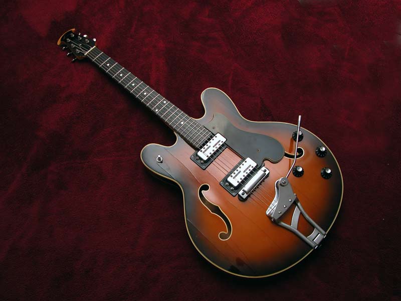

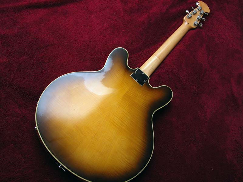

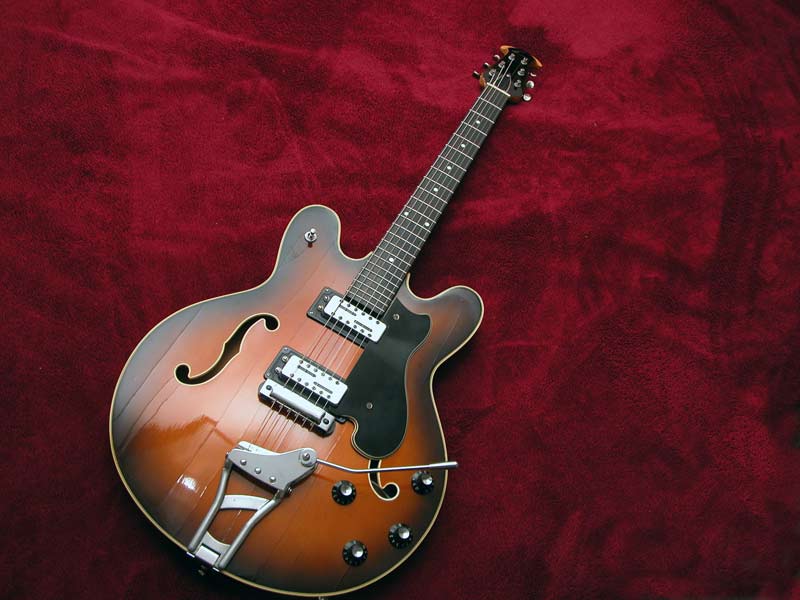

I bought this back in January. It's finally in my possession. It wasn't in very good shape at all. I've spent the last 6 hours or so taking it completely apart (except electronics).
flat end on the fretboard. no writing in the pickguard. She's a '68 alright.
Every thing's working great, but here what I did to it tonight. Those with a faint heart should stop reading now.

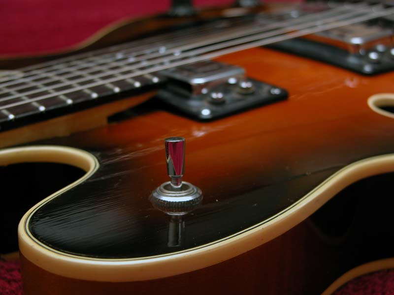

WHen I first pulled it out of it's case, I noticed a rough surface on the finish. It seemed like someone had coated it with sand, then put a clear coat over that. At first I thought it might be just an old uncared for finish, but then I realized the metal had the same issue, so I knew it wasn't in the finish. The guy who owned it before was a painter, so it was probably some overspray from a project or something. He told me he had planned to strip it dow and paint it. I'm so glad he didn't get around to it.
I tried everything. Damp cloth, elbow grease, Dunlop cleaner, Smith Cleaner. Nothing was talking this stuff off. Then I noticed I could scrape it with my fingernail and eventually it would come off. That would have taken forever, so I grabbed a no-scratch (the blue ones) scouring pad tried a small inconspicuous area first, it seemed to work so I started to go to town. 2 hours later, it was all off, and it didn't damage the finish underneath.

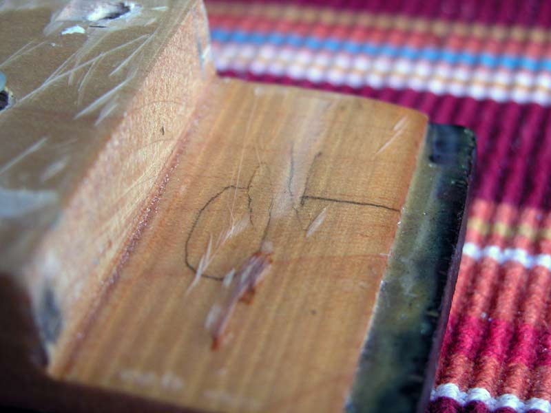

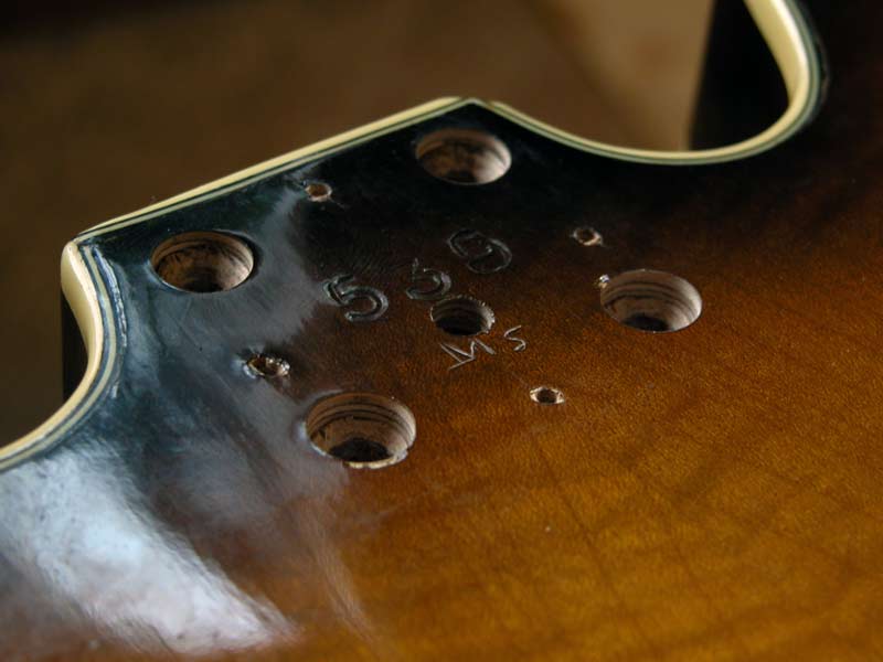

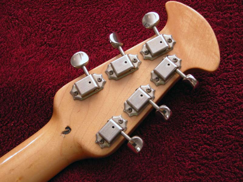

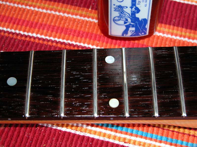

I took it all apart, neck was removed, the angle was re-set. As you can see, it was stamped with a "2", and I think it's because some inlays were off center (see pic). The neck has an "OK" under the finish. I'm not sure what the numbers and initials are under the neck plate.

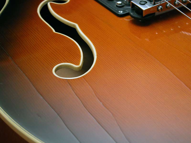

Aside from the finish cracks, she's a beaut!

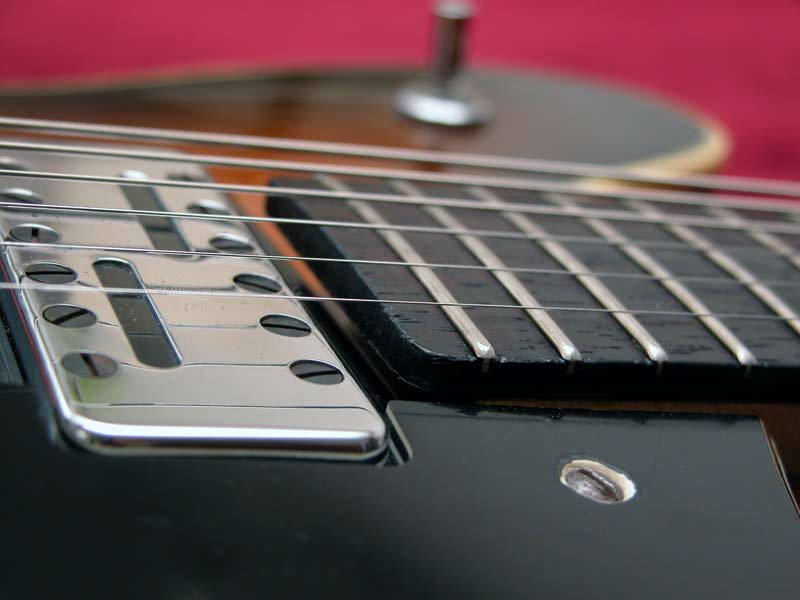

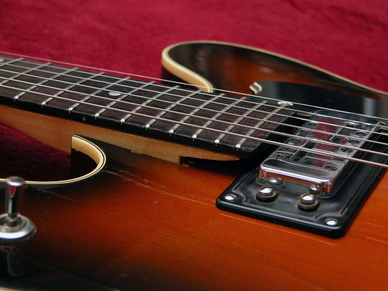

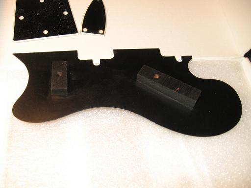

Looks like it may be missing a small wooden "spacer" under the pick guard comparing it to the one on my Eclipse.. keeps the PG parallel to the top.
Woody has my pick guard at the moment, perhaps he could snap a photo or 2 of what I'm referring to and you can work up a replacement.
Posted 2008-06-06 10:39 AM (#36121 - in reply to #36114)
Subject: Re: 1968 Tornado - The Storm is here finally!
I'd like to see that. It didn't seem to be missing anything. I wonder if they always had the spacer?
Posted 2008-06-06 10:50 AM (#36122 - in reply to #36114)
I'll do that tonight. I intend to replicate it as well. The "spacer" is Ebony - of which I just received a generous amount of in leftover shapes.
I'll try to attach to this post too.

Just a suggestion: remove the pick guard and check the body for an imprint around the screw hole. Also check the PG underside. If it had a spacer, chances are that you see some evidence.
The number stamped into the body under the neck plate is the serial number. On mine, it matches the paper label inside the bass-side f-hole. The scratched initials are probably just a previous owner marking it to prove ownership in case of theft or something.

As for that serial number, that's very good news indeed. I've found some conflicting info on these, some say they started in '67, some say '68. One thing I have figured out is that the flat end on the fretboard makes in a very early one. All the '68s I've seen have the "mustache" shape at the end of the fretboard, so I figured this HAD to be a '67 mfg. date. That said, there is no paper label in the soundhole.
A serial number of 565 would put it smack dab in the middle of '67.

As promised:
Posted 2008-06-07 5:42 AM (#36132 - in reply to #36114)
Mike, PM (or email) me a price and address, I'll send a check.
Or I sposed it could wait till the 4th. Think you could have it done by then?
And thanks. I didn't even realize it should have them.

Great guitar, nice early number. All of the storms I have ever seen have the serial # under the neck bold cover to match what was on the paper label.
