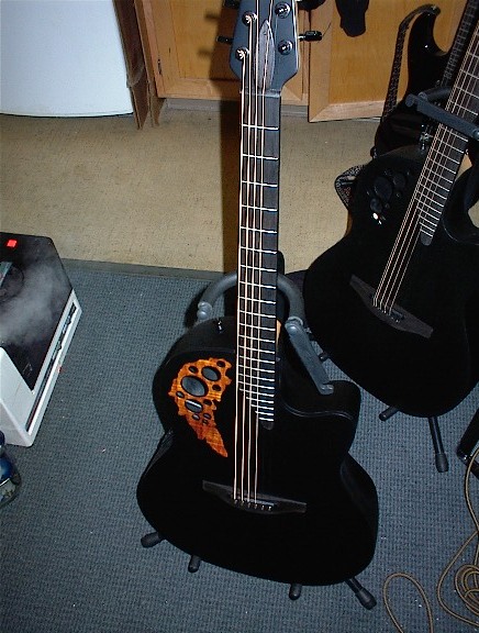

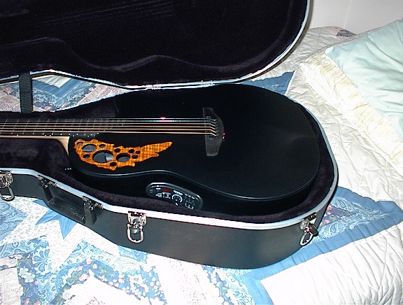

First... Here it is! :eek:

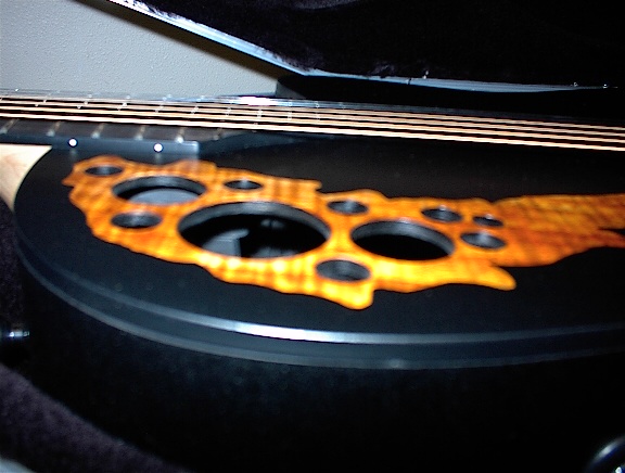

Also, The Koa Epi IS totally inlaid! :D

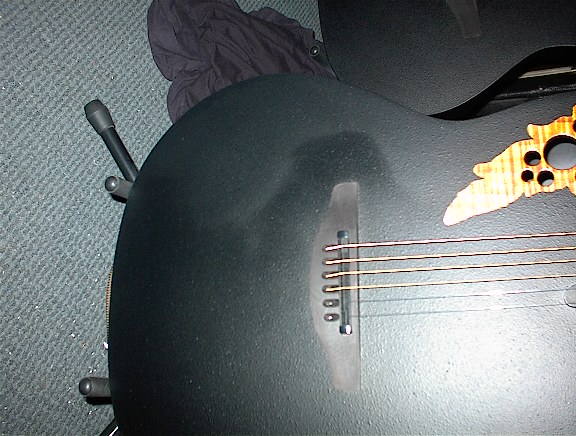

Now the Scare! First, the Sweetwater packing tape was undone, but that turned-out to not be a problem.
But what really scared me was that the finish was two-tone! It was shinier in some areas, and duller near the bass side...
But!... I took a damp cloth and wiped where it was dull, and nothing happened once I dried it...
So I wiped at the line where shiny and not so shiny meet... and it made the shinier area dull, like the other area. So I have decided that where it is dull, that is where the set-up person touched it.
Upon comparing to one of my other T's, the dull (matte) is what it eventually turns into. So far, I am satisfied!

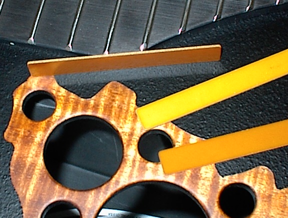

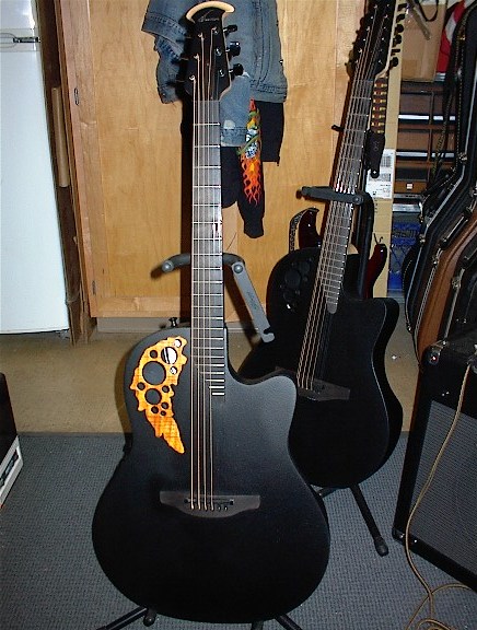

Okay, my strings on this thing were a "bit" high...
I was gonna wait until I had to change the strings to see what I could do about it, but after reading Oddball's post, I got inspired... Realizing that I wasn't the only one, I took Action! :mad:
Yeah, There are shims underneath my Saddle... A bit TOO Much I think....
There were three Thick ones under mine! They are different colors, but as far as I can tell they are the same thickness... Each one is alittle more than 1/32 of an inch!
I removed two, left one in... Looks like this...
Sorry that I neglected to take "Before" photos...

Thanx for diving in! Yours looks a lot better after the shims removal. You've talked me into removing at least one shim and restringing with some phosphor/bronze light nanos.
