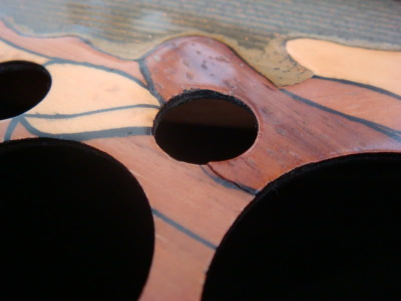

ARGHH! The 1537 has finally arrived but there is a problem!!!!
Please see here...
Piece is NO-WHERE to be seen! I am certain Fugot wouldn't have sent the guitar like this especially as it had been back to the Mothership a while back but I am really quite upset about this. Was really looking forward to it but sadly this damage has taken the wind out me sails :-(

That bit is missing from the pics in his auction if you look carefully. How's it sound?

This will most certainly sound like blasphemy on this forum. But there's a little trick that boaters use on old boats that works really well on interior varnish. Sure as shootin, some previous owner will have drilled holes or mounted stuff on an otherwise nice mahogany bulkhead. So even after you take the thing off or fill the hole(s), you still have visible flaws. So here's the trick: Go to the hobby story, buy model paint and a fine brush, and Lets Go Camoflauge! First is the brown base, mixed to match the mahogany. After that dries, streak the patches with a tiny brush with black or gold or tan to simulate grain — and varnish as usual. I swear to you that, done right, these things are indistinguishable by anybody except the guy who did it.
So I'm thinkin' a piece of popsickle stick on that 1537, a bit of stain, a bit of paint, a bit of clear and . . . .
Well, it's an idea anyway. Seriously, I can understand your upset if the missing chip was not specified on the auction.

dweezil, Take a breath... relax.
Surprises like this do take the wind out if our sails. I would be livid at first, but eventually, I'd calm down and work on a solution.
Talk, or write, to Mike.
He will not leave you hanging. Many of us have traded with Mike and there has yet to be a problem.
It appears from the photos, that the missing piece broke off along the grain on the lighter side and at a seam at the darker wood. I have repaired a few. A good luthier can make a repair that is unnoticeable. The Mothership might be able to provide a scrap from an old epalette to be used.
Until Mike gets back to you, play the 1537 and see why we all say that it is one of the best sounding wood topped Ovations.
Posted 2008-06-18 3:05 PM (#34190 - in reply to #34186)
Subject: Re: HELP! 1537 problem!
Dweez, what everybody has said is exactly right. That spot can be repaired.
I don't know why, but that little piece has a tendency to loosen up and catch on things, breaking off. Somebody who knows what they are doing can fabricate a new piece and you'll never know the original was missing.
In the end, it's a small piece and you're probably the only one who will notice it.
Like Bruce said, play the guitar and enjoy the sound. 1537's are great instruments. I've seen some in much worse shape and they still sounded great.....

Hey everyone - thanks!
Been waiting for some weeks for it to arrive and so was buzzing with excitement. I had 3 minutes to check it out before having to dash out again. So my initial thoughts were WOW nice but wait whats this?
Having had some more time to play it - albeit only for 20 minutes (plenty of time tomorrow as I have the day off!) and YES it's a tone monster, lovely woodyness and a balanced range, feels great to play too. I can see that I will really grow to love this baby.
I have emailed Fugot and yes looking at the auction pics can see it was missing before.
I shall ask the Mothership whether they might have a tiny piece knocking around but I suspect as they don't know me like they know a lot of you they might not be as forthcoming. We shall see.
I'm noticing it less and less already but would like to get it fixed - yes it's a piece of the light wood.
Thanks for all your helpful words!
Now that's classic OB, a popsicle stick on a 1537. :D
Be sure to attach it with Duct Tape!
It's not structural, so I call it character. If it was a crack in the top, now that's a different story.
Should have been disclosed though.

I emailed Mike first thing then posted here. My initial post did say that I didn't think Mike would have sent this out knowingly and in no way was slurring his good character - let's just make that clear from the off. I was just posting here to get some feedback/ideas from all you experienced O nuts.
And thanks for your thoughts. :D
Mike has replied and has been very apologetic about it! He offered to contact JB at the MS and to sort out a piece for me. From there I will get a local luthier to fix. As for cost and refunds well let's cross that bridge when we come to it.
So no worries, all will be sorted :)
And no it doesn't affect the sound :)
And what a sound! :eek:
The action was OK but I removed a shim and the thing flies, I think there are Elixars on there (not a fan - let's save discussing the merits of Elixars for a different thread!)
Apart from the missing piece the guitar is a EXCELLENT condition and sounds every bit as good.
Will post some pics when the epaulet is fixed, until then it's back to the wood shed.

I went back to the original post and the missing piece is clearly visible in the photos. That appears to be the only flaw in this 25 year old guitar. That is a very minor imperfection and I would not even bother the have it fixed. On a vintage and valuable guitar like this 1537, I think that you'd be better off leaving it alone. First of all it is unnoticeable from just a few feet away. Secondly, it in no way interferes with the function of the instrument. Thirdly, unless you send it to the factory the repair will be visible. Not as visible as the missing section, but visible nonetheless.
That's one mighty fine guitar. Leave it alone.
Edit: I just noticed that you have a Custom Shop "relic" Strat. So you paid good money for a new guitar that's made to look totally beat up, and yet you're upset about one small common flaw on a vintage guitar? :confused:
