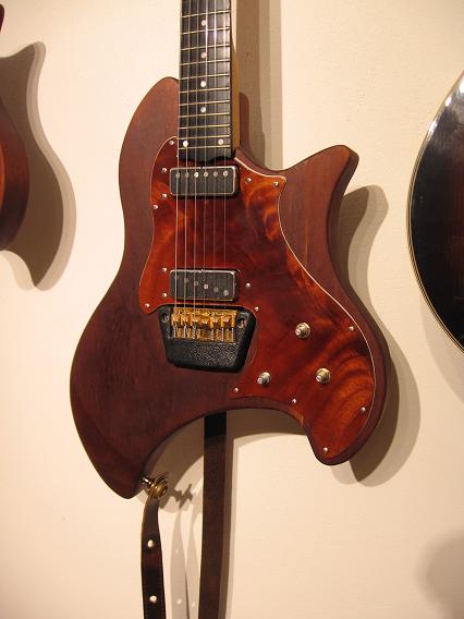

Okay, Here are photos. Any (additional) information and advice is greatly appreciated.
Do the tone and volume knobs look correct? I purchased them from a local guitar store because I thought they looked the the originals I saw in photos. Can anyone tell me if there was anything specific about Ovation knobs?
The FET is missing so the toggle switch does nothing.
The p/u toggle is a 3-position switch...but I don't believe it is original based on the white switch knob.
Upon close inspection you can see that there are exposed p/u mounting holes that are partially covered by the non-stock p/u rings/surrounds.
thanks (again) )to everyone for their help!

Posted 2008-06-02 10:06 AM (#303393 - in reply to #303385)
Subject: Re: Newbie seeks help with a Deacon restoration
Welcome to the club!
One of the best ways to obtain the electronics for a Deacon or Breadwinner is to pick up a Preacher Deluxe and exchange the parts.
Mile's is good for the stock pickguards and such but the pickups are getting more difficult to locate.
There are a lot of non-stock options out there with the "mini" sized pickups:
Seymour Duncan
TV Jones
Artec
Bill Lawrence
To name a few. There are more compact solid state options for active preamps and mid boosts as well.
Stock gives you a good project to shoot for though.
Enjoy!

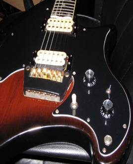

Returning to stock is a good thing, but if you ever decide to take a walk on the Custom side...
Posted 2008-06-05 11:41 AM (#303401 - in reply to #303385)
Woody,
Those are beauts! You do some awesome work.
BTW, your feline could be my Slush's twin. Slush went to Rainbow Bridge early last year after thirteen years and eight lives.
