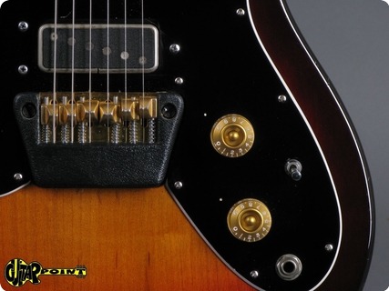

i've got my 2 pickup Viper almost finished. However, I think I may have an issue with the saddle heights. I have the black plastic designed bridge. Here is the question, it looks (to my eyes) that the strings do not mirror the radius curvature of the fingerboard radius. The more I look at it the B string is lower than the high E string. Is there an order, arrangement? Tried to take a picture, but it just doesn't come show it. Any advice would be appreciated.

Does your bridge and saddles look like this?
Just so we are talking about the same thing.
Have you tried swapping the B saddle with the E saddle?
And Yes, there is an order (I am guessing).
I have never taken one apart, but I would guess that that tallest saddles go in the middle.
I hope that helps.

Yep, we are talking the same type of bridge. I'm tempted to disassembled the unit and re-arrange if necessary. The pain would be re-setting the intonation. It almost looks like someone has swapped the high end with the low end. I bought this guitar used. I guess more research and pictures are in order before I do the swap. Yes, I did the B/E swap, and no difference was seen.

I compared the bridge on the 2 pickup model with my viper 3, and there is a difference. Seems that I am missing the two middle saddles, which have have the widest base and are the tallest. Anyone out there have a black plastic type bridge for the model 1271 they be willing to sell? I would like to get this project done. It plays fine, just isn't right. Drop me an message or email if you have a spare one and would part with it.

Here is the bridge in question. There is a about an 1/8 inch gap separating the high end from the low end. It looks like (compared to the my other viper) that I am missing another wide base saddle. I get the feeling that this bridge doesn't have a complete correct set. Anyone have any replacement set or complete bridge they would be willing to sale me?

My daughter's Preacher has the same bridge as you Viper. There appear to be 3 pairs of saddles. The high and low E have the same saddle (but turned 180 degrees from each other), the A and B strings have identical saddles which are slightly taller than the E - E saddles, and then the middle two strings have the fatter saddles which are the tallest.
You do seem to be missing one of the fat saddles under the D string.

Well, that makes me feel better I am not seeing things. Trying to find a replacement bridge isn't the easiest thing to do. I have some feelers out, but nothing firm yet. Keeping my fingers crossed.

My bridge problem is fixed. I emailed Mr. Budny. He had the newer Schaller Bridge in his inventory, and the rest is history. It's installed, and it works just fine. Eventually, I will go up to the neighborhood machine shop and see if they can make me a duplicate of the saddle I am missing. Kudos to John for the assist. Finally got around to taking pics of my Viper 3 and 2 pickup model. The 2 pickup model needed new tuners, a fret job, some pickguard screws, and of course the bridge.
