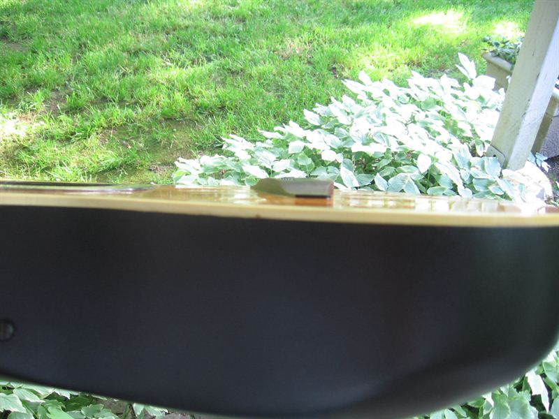

It has the Klusons and the sweetest grain I've seen in a long time. It also has a broken bottom and a top that will need a lot of gentle guidance back into shape... hopefully.
In order to remove the pickup I had to unsolder the wires in the preamp.

Nice job on the top repair.

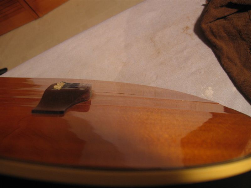

The belly bulge has pushed the bridge up quite a bit. Are you going to attempt a neck reset or are you trying to reduce the belly bulge with moisture?
Posted 2014-05-29 8:05 AM (#487220 - in reply to #487209)
Subject: Re: An Early 1615 Rescue Mission
Posts: 13996
I currently have clamps on the lower bout and moisture to flatten the area. The top is separated at the bottom and I hope to level out the top.
It's hard to say what will really happen. I've cut an access hatch and can see previous regluing of braces, etc.

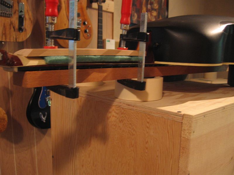

Posted 2014-06-01 4:21 PM (#487357 - in reply to #487209)
Posts: 13996

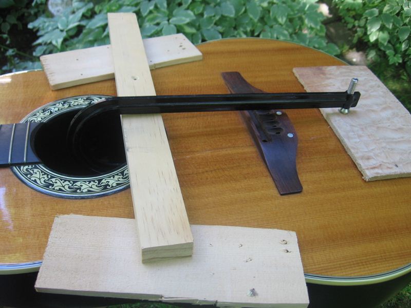

As it moves forward.
Edited by MWoody 2014-06-01 4:24 PM
DanSavage
Posted 2014-06-01 7:57 PM (#487365 - in reply to #487209)
June 2012
Posts: 2346
Location: Pueblo West, CO

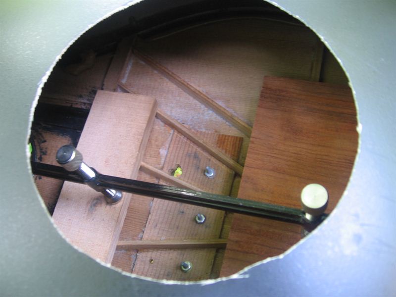

Interesting that you've got the leveling screw for the clamp on the inside. Can you explain what you're doing here?
Posted 2014-06-02 8:13 AM (#487376 - in reply to #487209)
Posts: 13996
I am trying to flatten down the lower bout and press up on the Bridge to Sound hole area. The arm of the clamp is in compression with the leveling screw.
If successful I'll re-glue the lower bout to the bowl and then fill the cracks. It appears to be moving in the right direction but time will tell. I get to turn the screw about a 1/16th a day. If it works, awesome! If it doesn't I get to put a new top on it.
Edited by MWoody 2014-06-02 8:16 AM

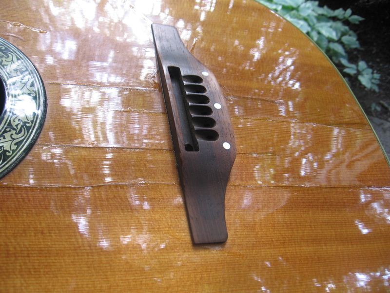

Posted 2014-06-03 9:02 PM (#487449 - in reply to #487209)
Posts: 13996
Fortunately it really wanted to get back in shape.
fill and level, repeat...
Edited by MWoody 2014-06-03 9:05 PM

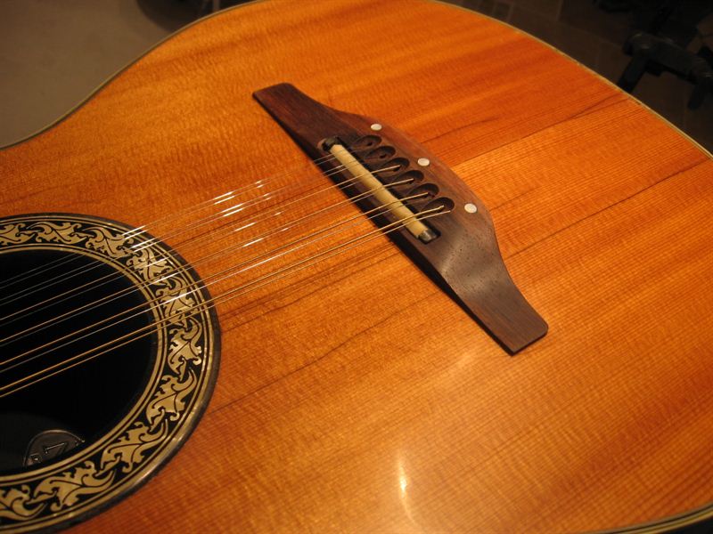

Posted 2014-06-04 11:08 AM (#487472 - in reply to #487209)
Posts: 13996
...and fill, and level...
This will likely require the Bridge to be sanded lower.
Probably add an OP Pro preamp.

Posted 2014-06-04 3:17 PM (#487477 - in reply to #487209)
Posts: 13996
Right now the Bridge "looks" high.
Once I feel everything is glued, braced and steady I'll throw two or three strings on and see what the action is.
It does look to have a thicker Bridge, not science, just a feeling.

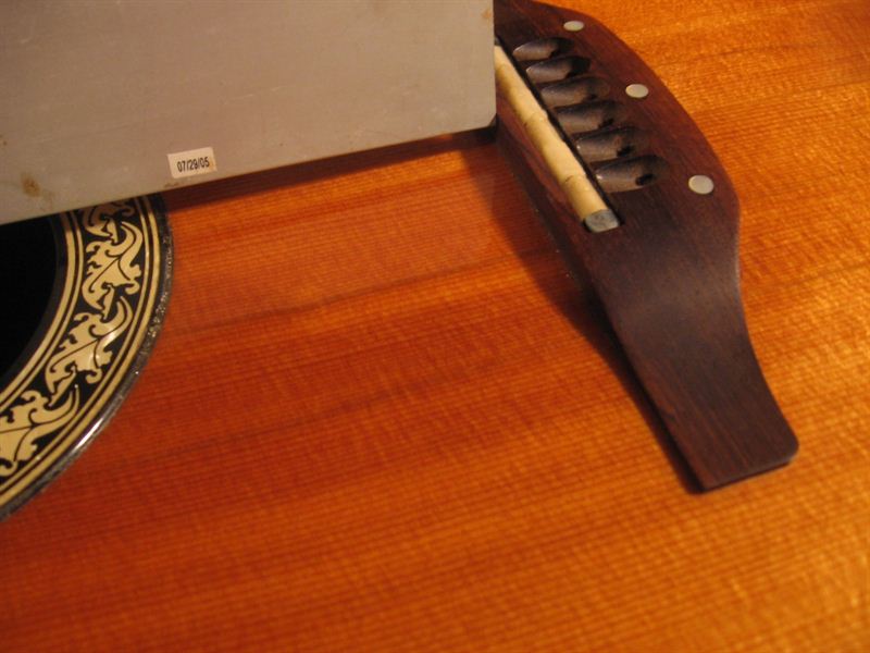

Does your straight edge still 'hit' the bridge in about the same location as shown in the pic below?

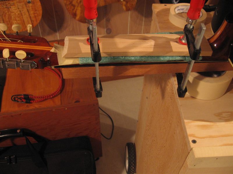

Posted 2014-06-09 7:55 PM (#487619 - in reply to #487209)
Posts: 13996

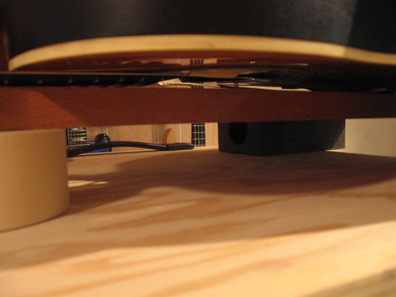

Performed a successful Bowl Bend on the 12 string!
Edited by MWoody 2014-06-09 8:00 PM

Posted 2014-06-09 8:12 PM (#487621 - in reply to #487209)
Posts: 13996
Ya, I'm just worn out from posting pics...
The Fretboard was aiming deep below the saddle, close to a half inch.
I clamped the neck to provide some push on the bridge area but to make sure that once things started to move they would stop in the right place.
Applied the heat in the shoulder of the bowl at first but what worked was hitting the sides.
Started low and slow and eventually made it to High setting at 1150 watts.
standing
Posted 2014-06-10 9:34 AM (#487634 - in reply to #487209)
December 2008
Posts: 1456
Location: Texas
I assume you fully loosened the truss rod first?

MWoody - 2014-06-09 6:12 PM
Very cool. Certainly a lot easier than attempting to pull off the neck to do a reset.
How much, if any, did the bowl deform in the process?

Posted 2014-06-10 4:02 PM (#487654 - in reply to #487209)
Posts: 13996
Truss rod was set in the last position of "relatively flat" and the "beam" was set to stop pushing once the top of the saddle was in line with the fretboard. Since the pressure was relieved it ended up just a skosh above - perfect.
Since I was in unfamiliar territory as far as "melting" the bowl I was cautious. When it finally yielded the bowl was very flexible on the main surface and I suspect just supple enough on the shoulders were the angles are present.
This was done visually, I would love to get a hold of a digital contact thermometer and map out the actual temperatures needed.
