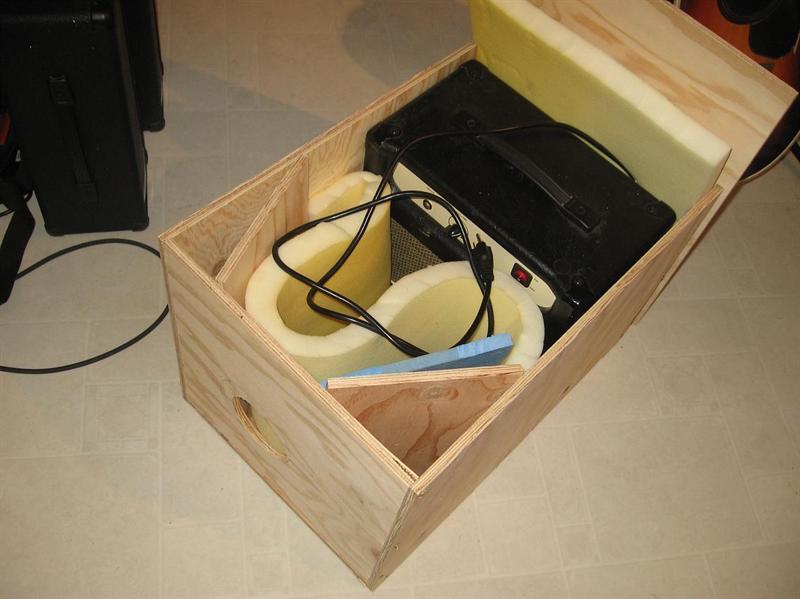

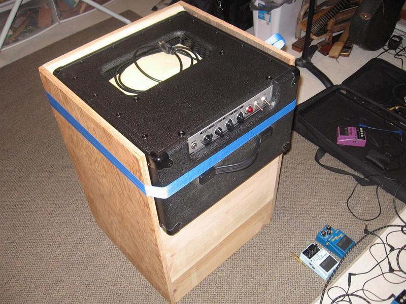

Thing Two is for a Valve Jr.
Thing One is for a Blackheart Little Giant 112 5 Watt Amp.
Any ideas on affordable sound dampening and such are welcome. We'll try these at services tomorrow.
Our mobile church sets up in a Gym so controlling sound is an issue. I want to regain the tone control using a Tube amp without stressing out the sound dude.

Posted 2013-12-08 9:33 PM (#480491 - in reply to #480471)
Subject: Re: Amp Isolation Boxes
Posts: 7248
Rockman / Scholz Power Soak works well, but iso boxes have been used for years, very reliable and while the sound is not exactly how the amp sounds when it's free-standing, the control afforded by an ISO box is well worth the effort. When I get my studio up and running I will have ISO boxes under the control room with access via a hatch. Ventilated and suspended, and completely isolated from the control room or sound room.
