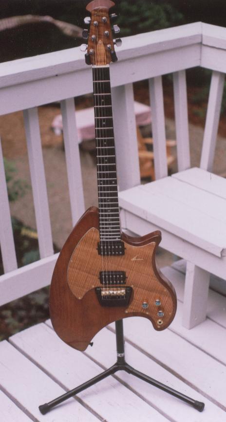

So let's say somebody was putting together a breadwinner limited type guitar. Theoretically. ;)
And not having access to original electronics, they were thinking "out of the box" and looking for a single-coil kinda sound. :eek:
And let's say they weren't too concerned about the existing pick guard and pickup cavity shapes/sizes/locations... :rolleyes:
Anybody got any recommendations? theoretically? ;)

Well, the BW Ltd had humbuckers, not sinle coils. So I assume that you're more intersted in the shape, not the sound?

As for what Rick said, I still have this PG with the Air Norton HBs. It uses a Blender in lieu of a 3 way and the Volume switch is a Lift Switch to make the HB a single coil.
I have it in drawer...

Miles, hopefully soon I'll swap you a Mahogany Viper, string thru, Piezo Bridge and P90 for your Thru neck while I make a pickguard for you.
It will need to be tested by a little more than Moody Chords!
The beauty of the Ovation Pickguard set up is that you can remove/replace them with a different personality in about 15 minutes by exchanging PGs.
