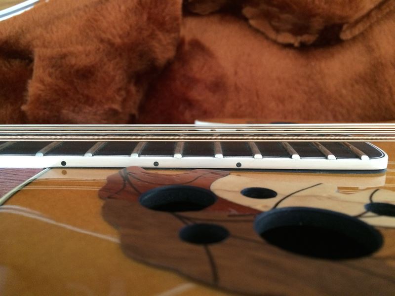

Hey guys I'm venturing into the world of learning about repairing Ovation/adamas guitars,a friend of mine who owns a music store and is a luthier is offering classes on guitar repair and we started my first project tonight.
I recently accquired an adamas 1588-7 and the action on it is high and you can see the neck dives down as it crosses the body,we took the neck off tonight and it looks like someone else tried to do a neck reset but got the geometry wrong,I took in my adamas 1688-2 that had been reset at the mothership along with the 1588-7 so I could show Matt(my friend who runs the store) a sample of what the proper setup of an adamas I was and I explained to him the floating fretboard setup you can see on the 1688-2 where there is a small lift on the fretboard extension as it crosses the body helping to keep the neck angle correct as it goes toward the bridge.
Has anyone created the floating fretboard effect when resetting a neck and what material did you use,it looks like epoxy on my 1688-2 but to do it properly do you build it up on the body?build up under the fretboard extension? or do you think they had some kind of jig/mold they used at the mothership when they put the necks on to create the proper thickness and shape of the resin under the fretboard extension.

Are you referring to the secret, magic black filler?

Yes,I want to recreate the effect when I reattach the neck to the 1588-7.
Attached are pics of my 1688-2 that I'm using as a guide.

To create a floating fret board, you could just not glue the fret board extension to the top.
That's what I did with my Frankenvation.

My Adamas II is fairly early... 83. The extension is not attached/glued to the top at all. Truly floating. For many years, I played winters in Colorado and the rest of the year beach side. Each time I returned to the humidity, the tip of the extension would curl down and vibrate against the top so I used a thin strip of felt there. When I got back to the thin air in the mountains, it would straighten out again. Could be why the mother ship eventually started attaching them? Anyway, not an answer. Just an observation.

Thanks for the input,I understand you don't have to have the fretboard extension fixed to the top I'm just concerned about creating a weak spot where the extension meets the body and I don't want the neck to be able to shift if theres nothing holding it to the top.
I looked at my 1688-8 which I don't think has ever had the neck off and the last few frets don't have anything under them but it is affixed to the top where the fretboard crosses the body from about the 14th fret to the 20th fret but not the full width of the neck,this is a 1994 model.

The fret board is pretty stiff on its own, so you don't really need to worry about a weak spot.
Even with a single neck bolt, such as are used on super shallow bowls, once the bolt is tightened, the neck isn't going to move, twist or shift.
There's way too much friction between the neck and the body for that to happen. It's a pretty solid affair.

I just caught up with this thread, here's some thoughts.
Can you remove material from under the fretboard and make a floating neck? Maybe... I would add epoxy and and a strip of carbon fiber.
If a floating neck starts to buzz? I have stuffed felt strap washers, credit card shims and picks underneath as a quick fix. Eventually humidity and normalization will fix it, everything moves on occasion.

It went quite well. This resulted in reducing material in the fretboard tail so I was concerned.

I had my next lesson/class tonight we cleaned up the neck heel and body where the neck attaches,whoever did the previous neck work put some kind of rubber cement on the neck heel and some little shims that looked like they were cut from the same kind of material as the saddle shims you see on most ovations,once these were removed and the black gunk cleaned up the neck fit almost perfect.
To create the floating fretboard effect Matt suggested we put a small shim under the end of the extension(about the 23rd fret) to help compensate for the dropoff,the shim was spruce and about .050 thickness and lifted the fretboard extension just enough that it created the same string spacing as I have on the 1688-2 I brought as an example,we glued the shim to the bottom of the extension then used epoxy to attach the fretboard extension to the top and fill the gap created by creating the floating fretboard effect with the shim.
The action looks like its going to be excellent all the way up to the 24th fret,were letting the epoxy setup and will continue thursday checking the level of the frets and hopefully stringing it up.
Dan:Matt agreed the neck bolts will hold it in place securely the epoxy was just to fill the gap under the fretboard extension.
MWoody: carbon fiber would have been cool to use but I was working with what was at hand so spruce and epoxy was our choice tonight but if I ever do it again I'll have to check into getting carbon fiber strips.
