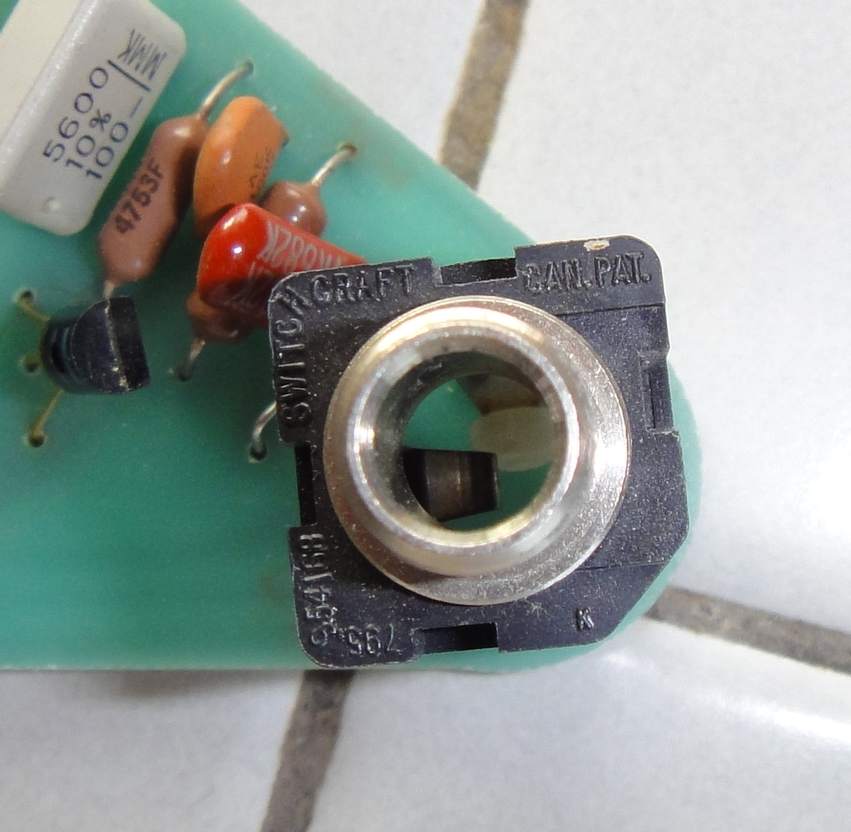

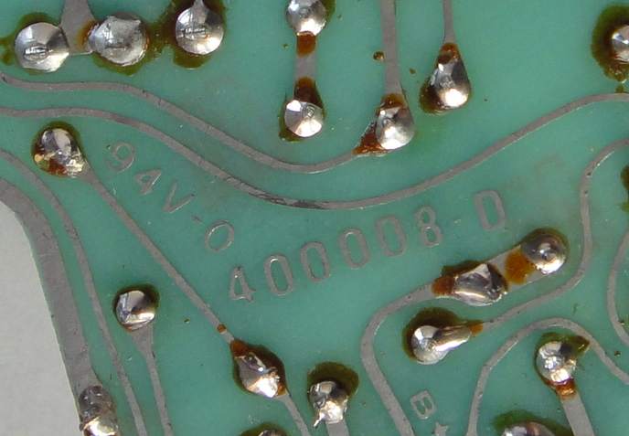

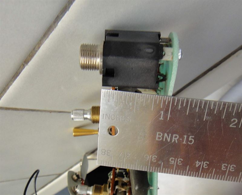

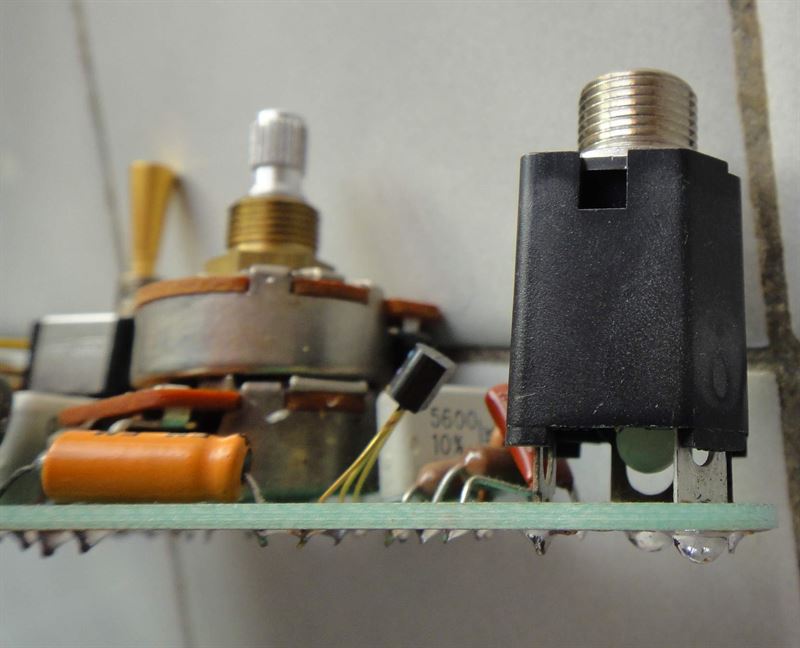

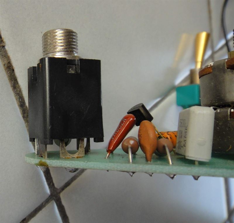

Pix of the jack on a rev. D board.  They're in an album here: http://www.ovationfanclub.com/megabbs/photos/photo-thumbnails.asp?a...
-Steve W.

Thanks for the link, it seems they have just the exact same jack Ovation used back then that even Switchcraft does not stock anymore. I have found (my tech friend who builds synth clones has loads of them!) a normal enclosed stereo jack that'll be just the ticket to get the preamp going. I suppose Ovation used switched jacks because they must have had loads of the thing as they were likely used in the stereo/mono guitars, à la Rickenbacker.
Anyway, I'm going to remove the remains of the original jack tomorrow and install the new one. Pinout is identical and conforms to the board so no sweat. I'm hoping the preamp will wake up.
