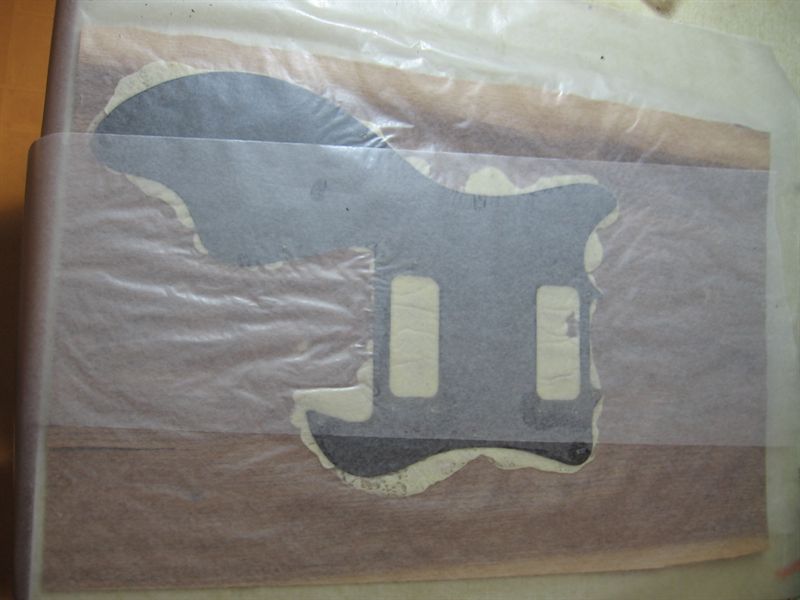

Someone recently inquired about pickguards and templates.
Here is what I like to do:

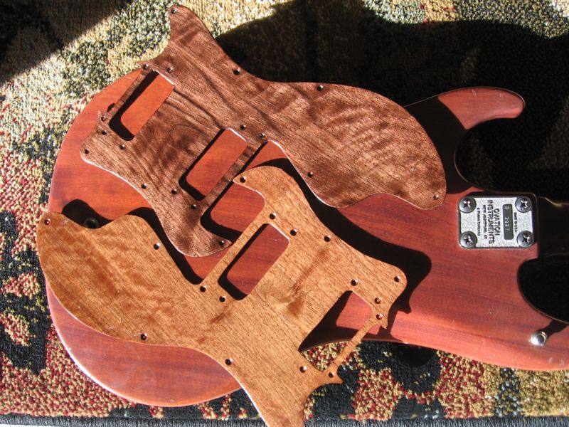

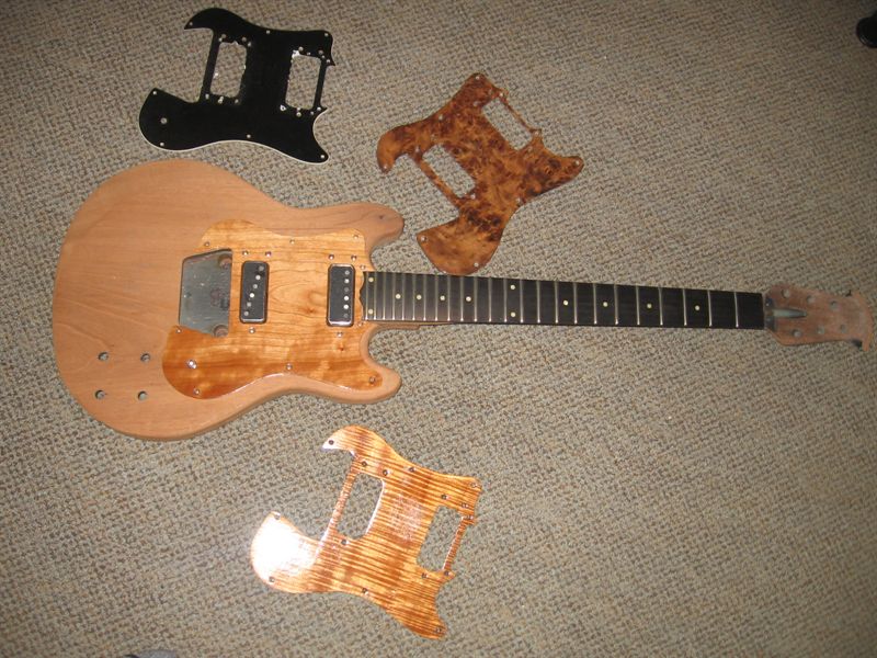

A couple of recent PD Projects,

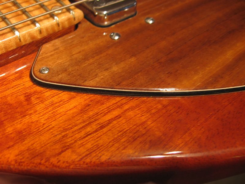

Exquisite work, Woody! In one of the pictures you posted on a recent post, you were holding a pickguard in your hand and it looked wet (watery). What was that material?
(The post was titled "Ovation Preacher Deluxe Pick Guard" in the "Welcome Center" area.)
Edited by Puppetman 2014-03-31 9:39 PM
Posted 2014-03-31 11:02 PM (#484664 - in reply to #483034)
Subject: Re: PGs
Posts: 13996
It is slathered in Gorilla Glue prior to going to the press.
It's an expandable glue that will lift a house if you don't push back.
Edited by MWoody 2014-03-31 11:06 PM

Why no pickguards on many Ovation acoustics? My Applause has a black plastic one but not the Pacemaker
Puppetman
Posted 2014-04-01 11:48 AM (#484673 - in reply to #483034)
Subject: Re: PGs
August 2011
Posts: 187
Location: Florence,SC
So, it's the plastic backing (stiffener) for the wood veneer pickguard? Ingenious.

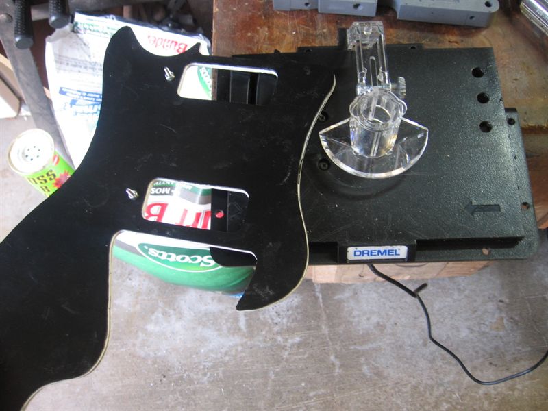

My new Best Friend! The Dremel Table Router. All you need is a couple of busted up old PGs and you can cut new ones in a short time.

I got one of those Dremel tables at a yard sale but have never looked at it. What kind of bit do you use? Do you need a template, or just draw on the plastic and cut it directly?
Posted 2014-04-13 9:56 PM (#485120 - in reply to #483034)
Subject: Re: PGs
Posts: 13996
Template needed!
Thick templates until I find the right bit.

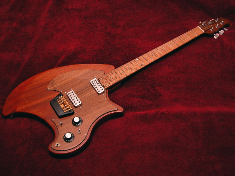

"So, it's the plastic backing (stiffener) for the wood veneer pickguard? Ingenious."
Ingenious, yes!
Original, no...
This is the inspiration - the Messina Deacon from 1985.
Edited by MWoody 2014-04-13 10:06 PM

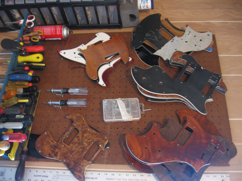

Mike, anything for the Hurricane? I have the holes but no guard.

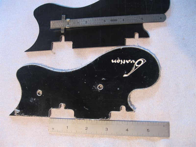

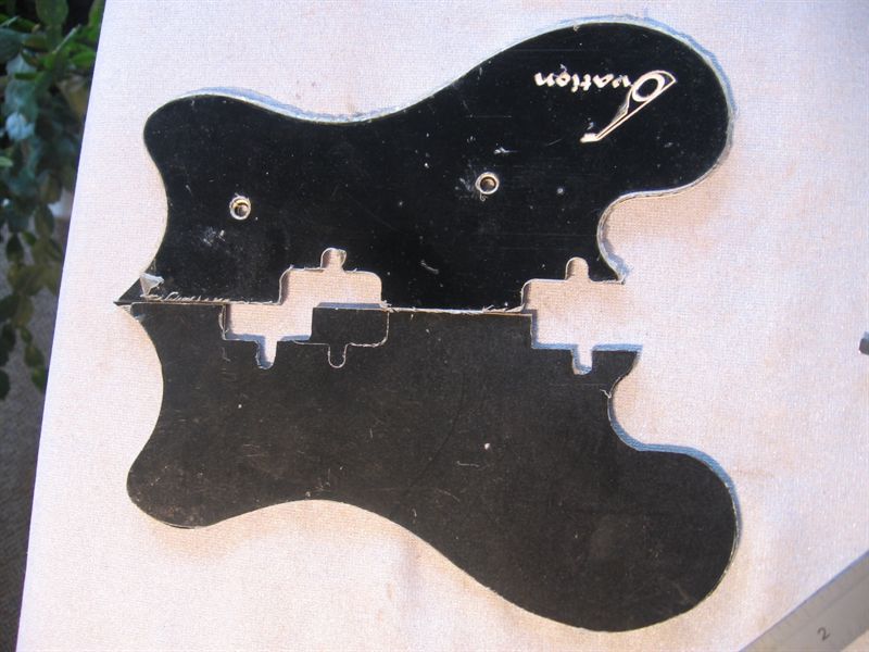

Posted 2014-04-15 1:18 PM (#485162 - in reply to #483034)
Subject: Re: PGs
Posts: 13996
Tony, I do have some for the Storm series. Let me post some photos with measurements.
Posted 2014-04-15 8:52 PM (#485168 - in reply to #483034)
Subject: Re: PGs
Posts: 13996
For Tony, This what I have, there are at least two variations:
Edited by MWoody 2014-04-15 8:54 PM
