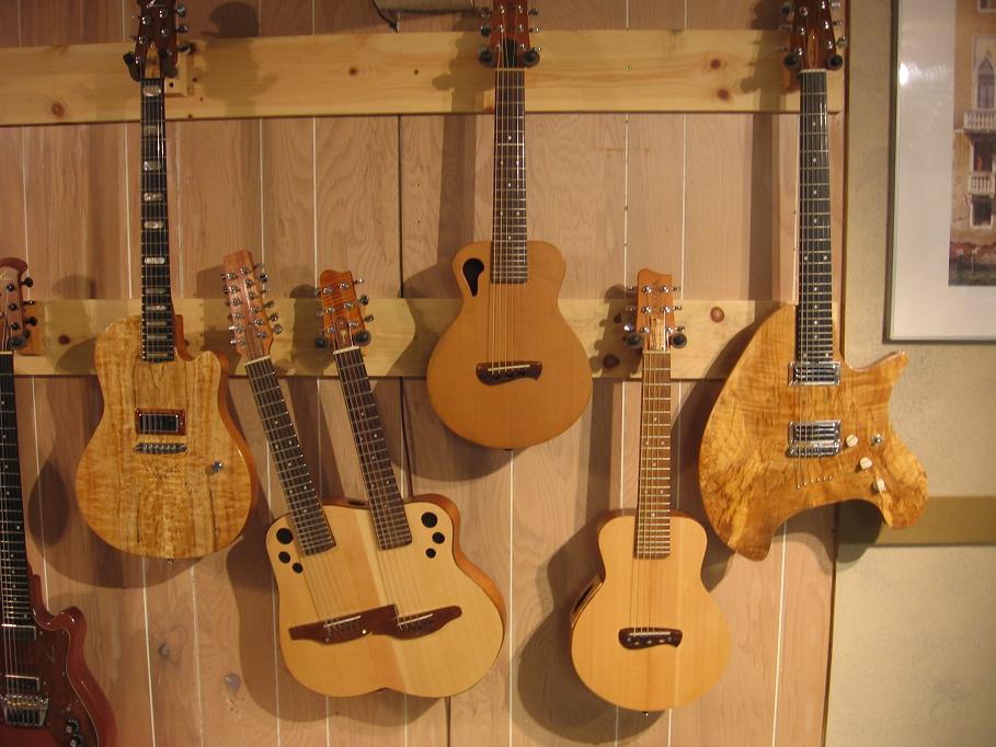

Here's an offering.
In there is a Tacoma Papoose and a Woody version, both A scale.
On the left is a Deacon shaped home spun.
A short scale on the Deacon shape would be nice!
Edited by MWoody 2014-04-16 7:04 AM

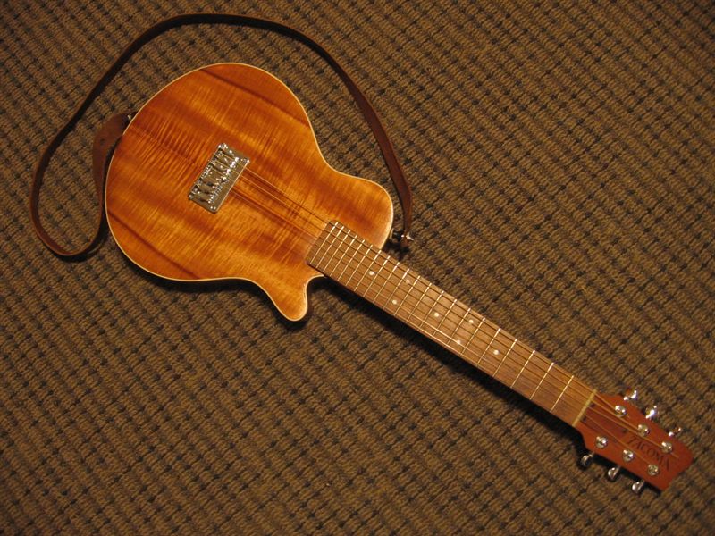

Also, here is a Papoose Neck on a chambered solid body Papoose.
Edited by MWoody 2014-04-16 7:14 AM
