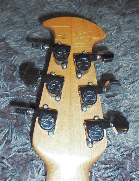

I looked at the necks on some online Vipers and viper II's but they seem to have a one piece head like this:
Viper Head
Mine seems to be made of two pieced joined along the centre line:
Parts Winner Neck

Measure the width of the nut and the distance from the nut (where it meets the fretboard) to the 12th fret. I don't have a Viper out right now and don't want to post dimensions from memory. Maybe Old Mr. Ovation has one handy or remembers the measurements.
Could be that the two-piece neck is associated with the ebony(?) fingerboard.
-Steve W.

I saw a picture of a breadwinner limited with the same two piece head stock but the wood was not maple.
headstock
Tornado looks like a one piece in 68
68 tornado neck
Edited by Blue280z 2015-09-24 8:56 PM
