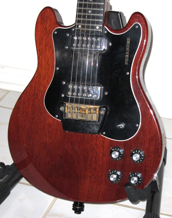

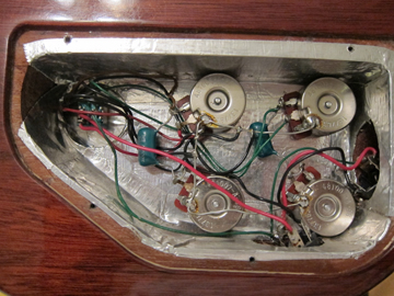

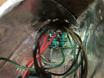

standing
Posted 2013-02-06 10:01 PM (#465004 - in reply to #464836)
Subject: Re: Preacher.... help???
December 2008
Posts: 1456
Location: Texas
Here are a few photos of my Preacher for reference:
Sketchly
Posted 2013-02-07 2:56 PM (#465022 - in reply to #465004)
January 2013
Posts: 5
Location: Somerset, UK
Brilliant! You're a star!! Thanks.
