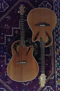

Right now the TBA guitar is a pile of parts, templates and materials. Gluing to commence shortly - those procedure pix will be interesting indeed. I am just awaiting the 2mm spruce reinforcement to go under the bridge. Epaulet reinforcements will be birch/balsa ply.
But here's a pic of my inspirations
Paul
