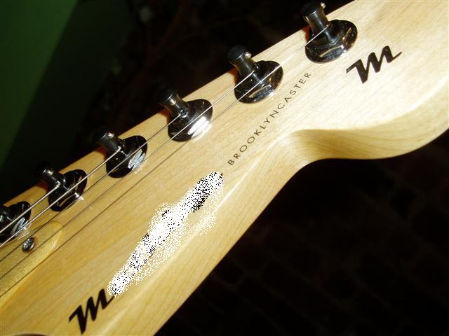

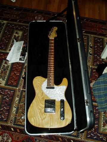

I want to thank the OFC. Along the way in building this guitar, I asked the OFC for suggestions, such as finishes, and pickups and tuners and felt on the end pins etc. And I want to tell you it came out great! I posted other pics in my gallery.
Thanks again! This place really is a great resource with really good people.

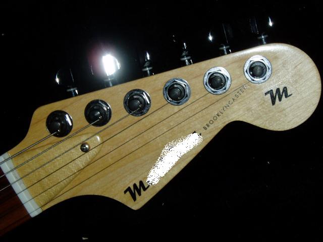

Looks nice, except for that ugly white smudge on the peg head. ;)

Posted 2006-12-05 4:27 PM (#228525 - in reply to #228523)
Subject: Re: OT: My telecaster copy.
Posts: 4389
Must be something wrong with my camera!
Joyful Noise
Posted 2006-12-05 5:14 PM (#228526 - in reply to #228523)
Posts: 629
Location: Houston, Texas
I think it says "Makita". Only it needs to be painted green.

Was that a Warmoth body/neck? Looks sharp...great job.
Have you seen the Buckocaster's posts on the TDPRI for 'built-your-own-tele?' Very in depth and a wealth of good information.

The neck and body are from warmoth's bargain bin. It's a short scale tilt back headstock strat neck.
Tru-oil is easy to work with. It's great for close grained woods like maple. No fumes in the house. Should have 12 hours between coats. The trick is to rub a small amount on with your finger. Let it rest a minute. Then wipe it off with a soft paper towel like bounty. It repairs easily, just sand a little and then wipe on more. It's not an instaneous finish like a spray on poly, but more forgiving.

Looks like a thin-line without the f-hole. Pretty!

Basically, that's what it is. It's a semi hollow body. It doesn't have the classic thin-line hollowing, it's the warmoth style. It resonates very nicely and has no feedback problems.
