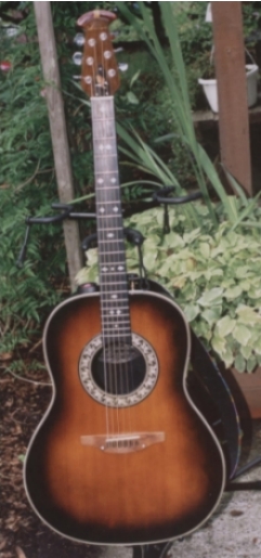

Posted 2005-06-02 12:37 PM (#148903 - in reply to #148881)
Subject: Re: Lyrachord versus Fiberglass bowls
It just keeps getting better every day!
Custom Balladeer
