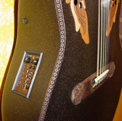

Randy,
last year I replaced the OP24 preamp of my Adamas 1688 to the Optima premp. It fits the same hole but the replacement is not as simple as most people think. The preamps are not 100 percent compatible. If you need more info don't hesitate to contact me. But I think the factory would do a great job!

Nice Karl. Yep that's what I am after. My 1688 has the original wooden knobs so I would never want to change anything on that one but my later 1587 ( I got from Al) has the deep bowl cutaway and it does have the little battery compartment door as well.
I will see what the factory says is the best way to go. If there is some minor mdifications I will be happy to do it myself but if it is fairly involved I will send it home and let mother take care of her.
Randy Thanks for all the help guy's!

I have done the exact same modification to my 1685 as well as to my 1986 collectors. All you have to do is enlarge the 4 screw holes where the preamp is mounted. Also you'll have to drill a hole in the bowl for the XLR jack. This can be a bit tricky. I decided not to do this, I simply desoldered the XLR jack from the circuit board.(you could always put it back later if you really need it) I hope this helps, good luck.
