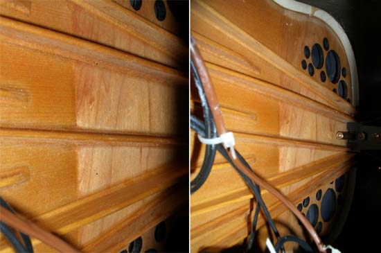

1537 Has Plywood Top ???
Posted 2005-10-16 3:35 PM (#133151)
Subject: 1537 Has Plywood Top ???
Please help me here. If you own a 1537, go open up the back and tell me what you see. I looked inside mine and I see a nice close grained spruce soundboard (it's even varnished on my older one). But looking towards the upper bout area, there is another layer of wood sandwiched to the soundboard. It's not spruce and it looks rotated 90 degrees to the spruce. It's very thin and tapered at the lower edge. So the bridge end of the guitar looks like solid spruce, but the epaulet end is a sandwich (plywood?). I thought I was seeing things, so I popped open the other 1537 I currently have and low and behold it's exactly the same. Are they all like this? Does everyone already know this except me? Are all Elite style guitars like this? Dave
Posted 2005-10-16 3:54 PM (#133152 - in reply to #133151)
Subject: Re: 1537 Has Plywood Top ???
Mine has the same, completely flush with the underside of the spruce. I had noticed this before but figured it was well known.
Posted 2005-10-16 3:55 PM (#133153 - in reply to #133151)
looks to me like a solid top with unique horizontal bracing...might have reduced a number of finish cracks, etc., if O had a couple of thin horizontal strips between the bridge and bottom (under or over the vertical bracing).
interesting - "varnished on my older one"...now that you probably have new strings on it - any difference between the two?
Posted 2005-10-16 3:57 PM (#133154 - in reply to #133151)
flush? in other words, a two piece backing - one upper and one lower?
Posted 2005-10-16 4:09 PM (#133155 - in reply to #133151)
By flush, I mean... mine looks like Dave's pictures but, in his photos there is a bit of an illusion which makes it look like there is a difference in thickness in the spruce and the 90 degree piece under the epaulet, when in fact there is no variation in thickness
....The underside of the lower bout is the same piece of wood as the top side, but this is not the case in the upper bout where the underside has the tranverse grain.
Posted 2005-10-16 4:37 PM (#133156 - in reply to #133151)
Jeff, I disagree. I run my hand over the "joint" and you can feel how the upper bout gently tapers to a thicker overall thickness (sounds odd, but you know what I mean). I've nevr seen anything like this. May it's what gives the 1537 the "mojo". If this is limited to only the 1537, I can understand how it would be a bitch to produce and maybe why it only lived a few years. I also notice that my '83 is varnished on the inside of the soundboard and the '84 is not. But they sound identical. Dave

Posted 2005-10-16 4:45 PM (#133157 - in reply to #133151)
February 2003
Posts: 2178
Can you feel the seperation between the woods at the joint?
Does it look as tho they rabbieted the spruce and placed on the plywood and then thickness sanded the two flush or just taper sanded the plywood?
TRboy
Posted 2005-10-16 4:48 PM (#133158 - in reply to #133151)
February 2003
Posts: 2178
Dave answered my question while I was typing it....He's magic! ;)
Posted 2005-10-16 4:49 PM (#133159 - in reply to #133151)
Dave,
I wasn't being clear, In your photos it looks like there is a lip where the pieces are joined, when, in fact (at least on mine), the joint is smooth and uniform thickness.
It is hard to tell whether the upper bout gradually thickens as it approaches the neck, because of the epualets, but it may well.
Posted 2005-10-16 4:53 PM (#133160 - in reply to #133151)
There is no lip. They taper sanded the ply. Jeff, I'm almost sure it thinkens. As I run my hand along the soundboard it's nice and smooth until the "joint". You don't feel the joint but you do feel like your now going up a small ramp. Overall this is VERY nicely done. I just never noticed it before. Dave
Posted 2005-10-16 5:07 PM (#133161 - in reply to #133151)
Confirmed. Using a modified cailper I was able to measure about 3/32 difference in the thickness of the soundboard. From the joint to the neck block.
TRboy
Posted 2005-10-16 5:13 PM (#133162 - in reply to #133151)
February 2003
Posts: 2178
Maybe (I'm guessing) they used the plywood for renforcement up near where they drilled all those weakening holes and leaving it nice and thin down by the bridge so the top could vibriate better!
The reason 1537's sound so good may be that the spruce top is much thinner than other multi-hole models but so thin that the area around the holes would snap and break easy.

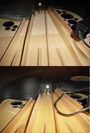

Posted 2005-10-16 5:22 PM (#133163 - in reply to #133151)
February 2003
Posts: 2178
Hey guys, I just pulled the covers off the backs of my '93 collector and my standard Elite and found that the '93 (which btw sound fantastic!) has the same piece of plywood as the 1537's but that the standard Elite is one piece!
I'll posts pics as soon as I can downsize my camera from 1200 x 1600
TRboy
Posted 2005-10-16 5:42 PM (#133164 - in reply to #133151)
February 2003
Posts: 2178
The Std Elite (bottom photo) has small pieces of plywood bracing the sound holes (not even tapered)
TRboy

Anyone have an Elite, Custom Elite or Elite LX they can look in and see if All multi-holes(except the economic Std. Elites) are constructed like the 1537's?
I don't mean to highjack this thread or step on Dave's discovery but now I"m curious too!
Posted 2005-10-16 6:46 PM (#133166 - in reply to #133151)
Posts: 13996
1778LX - Just a little bridge plate between the X brace. About 2" long.

I have a Std. Elite LX, and while I haven't looked in from the back, I noticed right after I bought it that there seemed to be an additional piece of wood by sticking a finger in from the top through the soundholes and kind of poking around. I figured that it was reinforcement for the top in the upper bout because it is routed out in order for the epaulets to be inlaid flush. The loss of thickness (and strength) is compensated for by the additional wood underneath.

ovation has advertised this in their catalogs in the late 80's, the one with 1758 12 string elite on the back cover..
on the page where the elites are showcased, it says REINFORCED WITH BURCH VENEER IN THE UPPER BOUT FOR OUTSTANDING HIGHS..
check it out..
ernie
Posted 2005-10-16 8:50 PM (#133172 - in reply to #133151)
Ernie nails it! Great work. So much for multi-ply tops not sounding any good, eh? Dave
Posted 2005-10-16 9:07 PM (#133173 - in reply to #133151)
Same birch that's used in the Adamas sandwich? That's a pretty good pedigree.

This thread made me wonder, so I took the access cover off the back of my Elite T and it does have a reinforcement under the holes.
I wondered what it would sound like playing with the cover off, tried it and it was thin and tinny sounding, wouldn't think it would make that much difference.

When you read "solid top", maybe they're describing how sturdy it is. Like Moody said, who cares how they build it. When the sound is rich we benefit. After all, these guitars were designed by engineers in the first place, and we all know how they are. Plywood and plastic have always worked well together. I've got a wonderful chair made that way, but it sounds awful.

I don't think you should worry about it being "plywood". I don't know how many layers it is, but it doesn't matter. Think in terms of layering veneer for strength. Luthiers actually go out of their way to mix different types of wood to come up with a uniquely voiced intstrument: like the one here.

Is a solid top any less a solid top because it has braces glued to it? That birch bracing is no different...
What is different is a plywood top, that's formed from a wood mash under pressure to form a board.....

And the answer is:
It's a solid top. The veneer(adamas core material, birch) was 1 layer run cross grain to keep the top from breaking between the holes, either in production or in the field. It does improve the highs slightly but that is mostly marketing rhetoric ( I know most of you spotted that immediately).
Most guitars of this style have this reinforcement.
