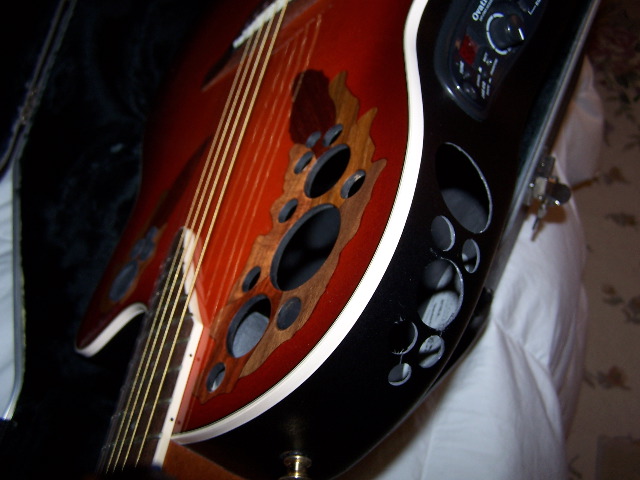

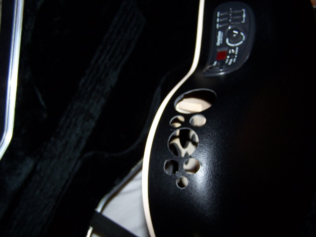

OK...I just caught up with this conversation. I'm quite sure I'm the only one here who has soundports in the bass shoulder of their Ovation and I can tell you without a doubt it works! It doesn't have any negative effect on projection toward the audience, either.
I've experimented with different set-ups, and ultimately settled on Air-Locks in the treble soundholes.
If someone knows how to put pics into this thread I'll email a picture to you.

Here are the pictures from John (bauerhillboy)

wow! nice job, John. it seems that acoustically the sound coming out the front of the guitar would lose some "compression" thus reducing the projection. perhaps sound wave properties do not function the same as, say air or water.

No scientific testing was done (nor were any animals harmed) to get to this point. I simply started with one hole and kept going. Things kept getting better as I kept drilling.
Big chance to take with a Std. Elite LX NEB but, hey...what's the worst that could've happened? I LOVE the results.

sure is purty!
what kind of drill bit(s) did you use?

I called Kim Keller and he discussed it with the guys in the shop, Since he had some thoughts on how to proceed, I took that to mean he didn't think I was a total idiot for trying this. Emboldened, I moved forward.
I started out by drilling the largest hole you see, closest to the preamp. I used a NEW Irwin spade bit...the kind with the points sticking out on both ends. It drills a starter hole in the center, then begins scraping a circle in the fiberglass with the 2 outer points. I had the cordless drill on SLOW and was careful to keep those 2 points scraping at equal rates. I held my breath for the duration...about 1 minute. Very neat cut.
I had intended for this to be the only hole I'd drill. As I played I liked the sound I was hearing, but I felt the hole was too far down the guitar to direct sound at my ears. I also felt I needed more holes to give me more sound. I thought for a few days.
After considering more drilling, I felt I wanted the pattern of holes to mimic the holes in the top. I thought this would result in something that looked "factory" done, rather than some schlocky home made attempt. (I have had several folks ask me if the guitar came that way).
I briefly considered making the holes the exact same size as the top holes so I could use AirLocks if I wanted, but I abandoned this idea because the drill bits don't come in those sizes. Also, The only reason to use Airlocks would be to increase the volume to the top holes, and this (as it turns out) is not an issue.
Measuring carefully for the centers of the additional holes, I drilled the next larger hole with a slightly smaller spade bit. This went well.
The smaller holes were a different story. Since the bits with the outer points are not available in those small sizes, I used regular drill bits. This was a mistake. This fiberglass is thin. While these holes don't cause any kind of structural problem, the area you're working with "flexes" slightly. Regular drill bits start out OK till the outer edges start to make contact. At that moment, the outer edges of the bit pull up on the point of contact and bend the fiberglass. The close proximity of the holes made drilling scary, and I did wind up with one crack in the fiberglass between 2 of the smaller holes. If I were to do it again, I'd ude a small spade bit to drill the small holes. It wouldn't have the same scraping action as the larger bits, but similar.
I won't do this to my '97 Collectors', but I may do it to the Pacemaker. This would be different since it has a hand-laid bowl rather than the injection-moulded one.
