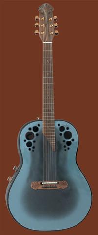

Do you know if it is possible to remove the traditional epaulets from the top of an Adamas ?
How epaulets are attached to the carbon top ? Are they glued ? Are they originally attached with a particular process (hot temperatures / pressure) ?
Perhaps my question will shock some people here, but it is a serious question.
I wonder to know if it is possible to change the epaulets for other ones (different design, like the ones on Kaki King's Adamas).
Thank you.

Changing original epaulets certainly destroys the value, but concerning my project, it is not a problem as far as I intend to keep the guitar.
Attaching the new epaulets with flexible glue could be a good idea.
But the main problem is to remove the old ones without scratching the top... And I don't know how they've been fixed on it.

After being inspired by Dave to paint or stain the epaulettes of my W579, I took it from the wall to asure myself again what a great sounding guitar it was, when I recognized that the bass side epi was lifted up a little. I pushed it up, just a little bit, to see the surface under it - when it broke. Okay, I said to me, this must be a sign. I took my wife's iron and ironed it, took the epis off - what was very easy to do - and now I am polishing the hell out of my right arm to get the glue off. Looks good to me - and makes me aware again how good it feels to have a wife :D
Pics will follow for those who are interested.

Okay, it's done.
Dude, I started polishing it with Clover Nr.3 (I think it is a german brand ?), but it was too smooth. I should have taken Nr. 1 or 2, but I didn't have them. So I took car polish (for metallic colors) and dremeled the glue away. Now it is quite perfect, but I will polish again with Clover Nr. 2 for the small sratches.
I like the look of the guitar much better now.
But again, I would think about doing this to a textured top. The question is, how to polish it without changing the look of the normally semi matte surface? The top is not glossy, with a lot of 'holes' were the glue will stick in. I don't think it is too easy to get that job done perfectly.

Waouh Kurt !!
It's fantastic !!!
What a job !
And what a look !!!
I was sure those black Adamas look like killer guitars without epaulets !
But you're right, on a texture top (which would be the case if I do that), the risk is high to make painting off.
I wrote to John. He kindly answered me. But the bad news is that for him there's a 50-50 risk that the epaulets will scrap painting...
I don't know what to do...

Drop dead gorgeous!! Now, if the Mothership made them like that in a lighter silvery gray, I might think about it.

My Advice: Leave them as they are! Even if you'll get them off without hurting the paint, it will be a awful job to remove the glue. It is not easily polished away. You first have to scratch carefully away the bigger glue pieces. Then polish, polish, polish. And this will be the next problem: The textured tops don't have a high gloss finish. After polishing it, these areas will be glossy. Not, if you polish them at last with a very rough polish. But I won't take the risk to ruin the guitar if I were you.
With my W597: If I had ruined it, I would have gave her a new Clear gloss finish. No big deal, that every good luthier could have done. But with an old textured top - I doubt that it would have the same appearance (gold flitter, burst etc.)
As somebody mentioned: Order one as a Custom Order. The good thing about this - you will have two Adamas guitars then ;)
Kurt

Kurt - Drop dead gorgeous. Man, I LOVE that look!!
