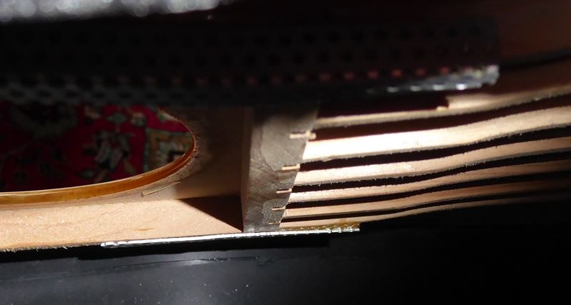

I finally got the wonderful 12 string parlor Ovation, but it shows some problems. The top has sunk between soundhole and bridge so much that even the metal pieces on the braces worked loose on both sides.I´m afraid that the whole construction will break one day. This guitar was definetely not built for the tension of 12 strings.
Any good ideas?
I´m trying to do the same what I did with an old 1619 before, bring pressure on the top from inside and use heat and patience...
And I´ve been telling all of you for years that a 12 string guitar should NOT be played with concert pitch...

So, back to this sad guitar. I'm posting a photo of the A-brace to help with my discussion. (Long read)
The A-brace is constructed with upper and lower sections. The upper section is made from two 5/16" wide pieces which run from the neck to the tail. The lower section is constructed from seven 1/8" wide pieces.
The upper and lower braces are separated by a transverse brace that is glued just below the sound hole. The upper braces are simply butt-glued to the transverse brace. The transverse brace is notched so the lower braces form a lap joint.
The glue joint betwee the two upper braces and the outer lower braces are reinforced with an perforated aluminum 90-degree strip. The perforations are meant to add gluing area, also known as 'tooth' to give the joint more strength. They also probably speed up construction as the underside of the strips don't need to be sanded as would be needed if they weren't perforated. It's these perforations that will complicate this repair.
What's most likely happened is that the high string tension caused excess force to be applied to the glue joints between the upper braces and the transverse brace. Since these are simple butt joints, they could not hold up under the tension and the stress was transferred to the reinforcement strips. From the photo, it looks like they popped loose from the lower braces, but are still firmly attached to the upper braces and transverse brace. It looks to me like this is the major component of the sinking top.
So, if you could glue and clamp the strips into their original positions, the majority of the sinking could probably be puilled back out.
Here's the complicated part; it's going to be difficult to line up all those little holes so the strips will be able to slide back into place.
What this means is that you'll probably have to remove the strips entirely, sand or grind the old epoxy away and re-glue the strips.
So, what I would do initially is to conduct a test. Get a piece of wood that is long enough to reach from one side of the guitar to the other. Position it over the transverse brace, then using a couple of C-clamps positioned over the aluminum strips where they join the transverse brace. Then, slowly tighten the clamps to see if you can bring the strips up so they're back in their original position(s).
If you can, then you might only have to loosen the clamps, apply some fresh epoxy to them and re-glue them.
If you can't, then you'll have no choice but to remove them entirely, clean off the old glue, or at least just the little 'pins' left behind by the glue that oozed through the perforations, then re-glue and clamp.
You'll probably also have to apply some glue to any braces that have popped loose. If you do have loose braces, you'll probably have to glue the braces at the same time the strips are clamped. Glue the loose braces first, then the strips. Use thin CA to re-glue the loose braces.
So, how do you get the aluminum strips off the braces?
I have used heat to soften the epoxy enough so the braces can be removed without bending them. Luckily, they're pretty stiff alloy. I'm not sure you can remove them without heat. You probably could, but they might bend. Worst case is you pry them off, bending them in the process. The good news is that you can email JB at the MS and he can mail you new ones.
The tricky part of using heat to soften the epoxy is that you will need to apply the heat directly to the aluminum strips themselves. I would not try to heat up the outside of the top. I also wouldn't try using a heat gun to heat them up from the inside. Instead, you'll probably need a small model airplane trim iron, like those available from Coverite. (See: Coverite 21st Century Trim Sealing Iron) Or, you could use a small soldering iron.
If you can't get the iron positioned correctly to apply heat directly to the strips, you'll have no choice but the pry them off cold.
Once you've re-glued the braces and the reinforcement strips, most of the sinking top should be fixed. At that point, you could use the method you used on the 1619 to flatten the top.

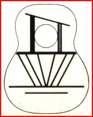

I can appreciate what you write. Like you I would never knowingly sell a defective guitar, especially to a fellow OFCer
IMO, the A-brace should not be used on a 12-string because of the stresses involved with the extra strings. Ovation never used the A-brace for their 12-string guitar, probably for this very reason. If someone wanted the sound of an A-brace on a 12-string, the K-5 braces would be much better suited for this job. Both have nearly identical tone.
Unlike the A-brace which uses separate upper and lower longitudinal braces, the K-5 brace pattern uses two massive longitudinal braces which run continuously. These are lap-jointed over the transverse brace and form a very strong system of support that would work very well on a 12-string.
Here's a pic of the K-5 brace pattern.

According to the archived OvationGuitars.com web site, the 1618 GC 12S used Ovation fan braces, as do all of the 12-fret CL 12S guitars.
The 1970 Catalog on Ovation Tribute says that the 1118 GC 12S uses Ovation Fan bracing.
I'm also going to check my 1655 12S. I believe it uses the Ovation VT-12.
The 1988/89 catalog shows the 12-fret 12S were still using the Ovation fan braces, while the 14-fret 12S use the Ovation A-12.
I'm guessing that the A-12 braces look like this:

FWIW, I just checked my 1982 1655 12S and it definitely has the brace pattern show below.
Because it's very similar to the K-5 braces, which are a variation of the A-brace, I'm going to guess that these are the A-12 braces referred to in the sales brochures around this time.

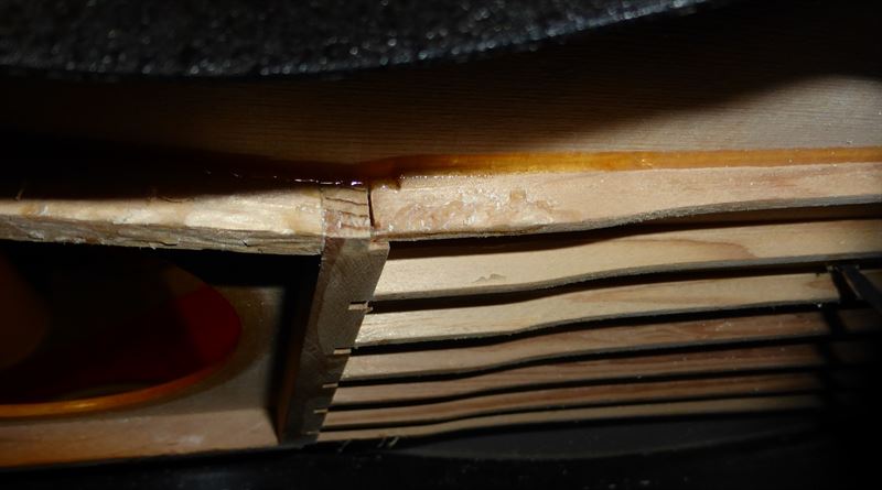

To remove the metal parts was easier than I thought. I tried an infrared-lamp first, but with a soldering iron it was quite easy to heat up the frames. And - it was easy because there were only tiny drops of glue (less is more?).
In this case it was easy because I have the additional hole on the side of the guitar where the preamp is.
(If you want to bring heat on the inner side of a top through the soundhole, you can also use an infrared-lamp and a mirror! I used this at the beginning of the heat treatment of the top.)
Looked not too bad, no loose braces, no cracks, just little structural deformation...
But I could not bent the top more than I did before (and it was quite a bit), so I left it in it´s actual stage.
I egalized the steps between the different wood parts so that the metal would fit more precisely and glued them both back into place, leaving my "top pressure construction" inside for the drying process.But I used more epoxy (more is more).
Now the epoxy must dry and I´ll have to wait how all this worked.I´m hopeful that I did not make more damage to the guitar than there was before. And all my A-braced guitars have tops with warps and waves, they can stand a lot.

Sure I will, the epoxy joints are going to get plenty of stress. But that´s one of the things I really don´t have: patience...it´s really hard to have this gem in your hand and you can´t play it.
The guitar has an op-pro/studio preamp with a big side access hole, thus I could make pics from strange angles..

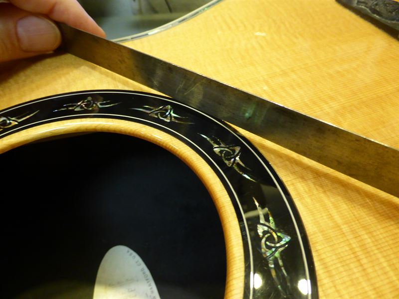

Hi Arumako, I had the same idea of additional braces:-) You always have good ideas, I remember your tricky bolt-on neck construction. I will decide about it when I tried the strings on it.
Before the treatment the top had a concave bow of 4mm , now it´s 1,5mm:
Not so much worse then other guitars I have.
I can easily observe it if any changes will occur.
I will let the guitar rest without the pressure tool until tomorrow and then string it up.

I was looking at the pic below.
Now I can see what happened. This should get further attention before you string it up.
It looks to me like all of the lower braces have sheared out of their sockets in the transverse brace.
I noticed in the end brace closest to us that the joint is wider toward the bottom of pic and smaller at the top where it is glued to the top.
I also see that all the tops of all the braces are parallel to each other.
Since both of the aluminum braces were popped off equally, this tells me that all these braces are probably loose in their transverse brace joints.
I would clamp the area again, then wick thin CA into each of these joints and let the glue dry. I use CA accelerator so it only takes a few minutes for the glue to dry.
Edited by DanSavage 2017-10-26 8:56 AM

The braces are all tight, but I think that the glue itself changed structure with the time. I guess that I could reverse this a bit with my heat and pressure treatment. In the gaps between the wood parts are too many hard drops of the glue so that you cannot simply bend the top without causing toomuch stress on the braces. All this would be quite easy if I would not have to work through the soundhole.
The alu pieces were fixed with very small drops of epoxy and besides that they are not hard at all, I would say smooth. I could even adjust them to the uneveness of the wood parts, maybe I can make a pic later.
I decided to add 2 braces on the sides of the center part of the bracings where the stability problem is. I got a piece of rock-hard 100 yr old spruce from a violin maker in the neighbourhood and made 2 braces out of it. I don´t think they will affect the tonality of the guitar. I first had in mind to built reinforcement "pickaback" braces for the center section, but because of the angle between the pieces I refused this idea.
I made the add. braces straight first and tried them on the top inside and the top seemed to be very straight at this place.
I make pics tomorrow.
