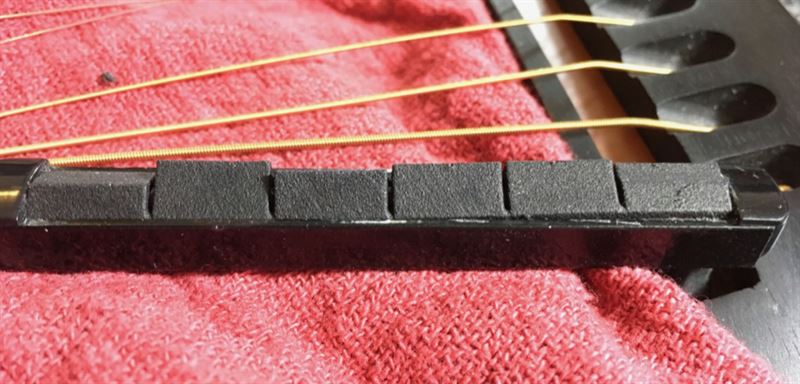

Here's another problem with the OCP-1K -- poor intonation, especially at the low E and A strings.
Luckily, there is a solution -- 3D printing. First, a little back story.
After completing my 1778T(orrefied), also known as my Frankenvation, I was pleasantly surprised that the intonation was nearly perfect across all six strings. This is a result of the slanted-slot bridge (thank you, Beal!) and a compensated saddle.
Below is a photo showing the difference in the saddle breaks between the OCP-1K and the later slimline saddle. Generally, the Ovation steel string guitars have a scale of 25.25". This places the front of the bridge at 25" from the back of the nut.
So, both of the bridges would be glued to the same place on the top. As you can see there is a significant difference in the saddle breaks on the two bridges.
I measured the distance from the front of the bridge to the saddle break for each string on the slimline saddle, then designed a replacement OCP-1K saddle that placed the saddle breaks as close as possible to the slimline saddle. I was able to relocated all of the strings except the low E to the same distance as the slimline.
Here's a table showing the measured differences. What this shows is that the low E and A is out of tonation by over an 1/8", which is a bunch. =O
Slimline
EADGBe
.56".50".43".40".46".33"
OCP-1K
.38".35".35".35".35".29"
Difference
.18".15".08".05".11".04"
And, here's the 3D model of new, compensated saddle. The low E is closest to the camera.
I sent the file off to the 3D printers and got them back today. I ordered a copy using two different printing materials. Both are nylon. The white, already installed in the pick-up, is a little lower resolution and a little courser surface. The black, sitting on the desk next to the original Ovation saddle, is higher resolution with a smoother surface.
I installed the new compensated saddle into my Book Elite and I can report that this experiment is a smashing success! The guitar now plays in tune up and down the neck on all the strings, just like my Frankenvation and I couldn't be more thrilled. The low E is a few cents out at the 12th fret, but that is very, very minor.
I'm going to play this saddle for a few days, then swap it out for the black one so I can hear if there's any difference to the white one.
Edited by DanSavage 2019-01-18 1:43 AM

I'll probably change out the saddle tomorrow. I've been playing the Book Elite and I think I've got a pretty good idea of how it sounds.
Afterward I'll make the models saleable and you can order one directly from Shapeways.
I did plug it in and all six strings sound fine through the amp. I was concerned that the low E might not be pushing down hard enough on the piezo to get a good signal, but that is not the case. It sounds as strong as the other five strings.
Edited by DanSavage 2019-01-18 11:53 AM

Ok, I'm in. I have to tune my low E strings flat so that the fretted G is in tune with the 3rd string. Fixing the intonation would be welcome.

I couldn't wait until this weekend to try out the black saddle and I'm glad I swapped it out.
Al,
As you postulated, the smoother surface of the black translates into a denser final product. The tonal qualities of the black material is closer to the OEM plastic than the white. I'm making the white available for sale for those who want a white saddle. It still sounds really good, just slightly muted compared to the black.
Ken,
Yes, I believe that Shapeways will ship to Japan. If not, let me know and I will!
WRT to durability, the fused nylon is pretty tough. The black sounds closer to the OEM plastic than the white. I was curious how deep the string dents would be in the white and they don't look any worse than the OEM plastic.
FlySig,
Yeah, the intonation problem you're describing with the low-E is completley fixed with this saddle. And, not just the low-E, but also the A and B strings as well.
Kevin,
Ovation was aware of the problem, which is what lead to the slanted slimline bridge with compensated saddle. (Thanks you, Beal!) I can't say why they didn't apply the same sort of fix to the OCP-1K. Yes, as a matter of fact, I did put these on a strobe tuner and even videotaped the resultes. See below. :D
So, how does the new saddle sound compared to the OEM saddle?
Here's a couple of video clips. The first is of my 50th Anniversary Custom Legend with the stock saddle. The second is the black compensated saddle. I'm using a Peterson strobe tuner. When the strobe rotates to the right, the pitch is sharp, to the left, flat.
Intonation Demo of Stock Ovation OCP-1K Saddle
Intonation Demo of 3D-Printed, Compensated, Ovation OCP-1K Saddle
For those who want to order their owm, you can visit my Shapeways.com page.
Ovation OCP-1K Fully-Compensated Saddle
Edited by DanSavage 2019-01-19 1:12 AM

Because of your inquiry I pulled my 1624 down from storage and swapped out the saddle.
In a word, it sounds fantastic. Not only does it fix the intonation of this guitar, but the white nylon actually improves the tone. More sustain across all six strings and clearer notes. I haven't tried the black on the nylon string guitars, but based upon my experience with the steel strings I know that it will only make a guitar like a 1624 sound even better.
Here's a comparison between the OEM saddle and my fully-compensated saddle. The OEM has some sort of weird Takemine staggered saddle action going on. Some strings intonated sort-of correctly, others didn't. It was like the guitar was slightly out of tune.
What a difference the compensated saddle makes!

Good results so far with replacement saddles. Peeling off the original plastic saddle really is easy, and the new saddle completely solves the low E intonation problem.
1) No discernible tonal difference with the white saddle in the 1537 compared to the factory original. It dropped right in easily after removing the original saddle.
2) The stereo pickup in the 1537 has an interestingly different construction with copper tape along the top surface rather than soldered wires. Being stereo, there must be 2 wires on the bottom of the piezos. This is a late Fender era replacement, not the 1983 original.
http://www.ovationfanclub.com/megabbs/photos/get-photo.asp?photoid=...
3) The black replacement saddle for the 2080 is not sitting totally flush at the 6th string. The saddle is .011" longer than the original, and there is an excess of RTV/silicone inside the pickup. With some filing of the saddle and trimming of the silicone it fits laterally but is still not flush at the 6th string. I believe there is still some excess silicone, and possibly the silicone is off center along the piezos. It trims off very easily with an X-Acto knife. Acoustically it sounds normal but plugged in there is almost no signal from the low E string. With a bit more careful trimming of the silicone I think this is going to work fine.
4) I would love to have an off-white color that looks like unbleached aged bone rather than the bright white.
5) When retuning the strings, eyeball their position carefully over the new saddle so that they are properly spaced. Once up to pitch they will create a small notch in the saddle, so spend the few seconds to get it right.
6) Someday I'll figure out how to post pictures on this forum so that they display. Jeez.

FlySig - 2019-02-09 6:01 PM

DanSavage - 2019-02-10 9:00 AM
/>Have you been able to compare the old saddle to the new one to determine if they are identical? How does the old one fit into the pick-up?
Given that the new one shares idential dimensions with the OEM, there must be a reason why it's not settling into place.
The length of the new saddle is .011" longer than the OEM saddle. Upon first installation it bowed upwards because it was too short for the available space. The OEM white saddle from the 1537 is the same length as the black saddle from the 2080. There was definitely a lot of silicone inside the pickup assembly, including at the ends. Even with trimming it out, the saddle was still just a titch too long. It was easy enough to file a little off of the ends.
However, the front edge at the 6th string is still sitting proud. I expect the problem is too much silicone inside the pickup assembly. The cavity is totally full of the stuff. The bead across the low E piezo crystal appears a bit crooked by eyeball. Later today I will take it apart and carefully remove more silicone as well as compare the two saddles.

That's weird. I just checked my black saddles and they're the exact same length as the OEM saddle.
For your black one, make sure to sand a little off each end so the slots are between the piezo crystals.
Looking at the inside of the pick-up a couple of the piezos are crooked and the low-E looks like it might be off-center. Even so, this shouldn't prevent the saddle from fully seating.
The amount of silicone looks normal.
Is the profile (cross-section) the same between the OEM and new saddle? Specifically the low-E.
Try putting the saddle in backwards to see if the problem is with the saddle or the pick-up.

FlySig,
Do me a favor. Compare the length of the black and white saddles and let me know if the black is longer than the white.
Even though the black will be shorter than the white because it's been sanded, the slots on both should all line up.
If Shapeways is sending out different size parts, I'd like to know that so that I can address it with their tech support.

By eyeball I can't see any difference in the length of the new black vs new white as they are installed by comparing them to an old saddle held next to them. Not very precise. I can pull the saddles off at the next string change which will be next week or so. The new black saddle measured out at 1.766", whereas the original black saddle was 1.755". I did not measure the new white saddle before installation.
The inside distance between endcaps on the saddle assembly is quite different between the two guitars. The black one on the Adamas (2008) is right around 1.763", whereas the white one on the 1537 (stereo, 2014) is 1.785". I can imagine the assembly process results in a lot of variation in that dimension.
The black saddle assembly was chock full of silicone. Squeeze out filled every spare space. With some careful scraping and picking out, the new saddle now sits flush and works perfectly. It did need to be shortened ever so slightly initially, but the dead low E piezo was due to all the silicone inside the assembly. There was quite a bit down in the longitudinal channels that could have been jacking the new saddle up, or it could have been the center ridge of material on top of the piezos being too tall. The material was very easy to trim out with an X-Acto knife and good lighting.

FlySig - 2019-02-10 2:21 PM
Phew! I'm really happy to hear that you got it working on your 2080.
WRT your measurements, I'm sure you mean 2.### and not 1.### as the 3D printed saddles are, as designed, 2.75" long.
I've got 3 black saddles installed. I ordered the first one with the white one I antiqued. Then, I ordered two more black ones on a separate order.
I measured the saddles and the space between the pick-ups using my digital calipers.
Saddles: 2 - 2.75", 1 - 2.76"
Pick-ups: 2 - 2.78", 1 - 2.8"
I also tested three different spare pick-ups and the space between the end pins was 2.78". I'm sure I could keep testing guitars, but I would probably find that these are all about the same distance.
It looks like the black saddle you ordered was probably marginally larger, like one of mine. But, your space between the end pins on the pick-up was the same distance, which explains the interference fit on length.
You're the first one who's reported a problem with the saddle being too long. Those who have got theirs report that it just drops right in.

I received the black saddle for my 1624 Country Artist and just finished installing it. I like the way the black looks. I can't say that I detect a noticeable difference in tone. At first I was disappointed in the intonation, until I discovered I'd installed the new saddle backwards! Intonation is within 0 to 5 "cents" at frets 3, 5, 7 and 12 except for the G string, which is +10 at the 7th and +15 at the 12th. It was the worst string with the old saddle as well and, overall, the numbers were somewhat better with the new saddle. I noted that finger position/pressure could result in 2.5 cents variation from test to test. I confess that I don't know what's good or bad in terms of cents but my ear isn't sensitive to detect anything objectionable. In any case, I don't spend that much time beyond the 5th fret anyway. My strings are still settling in after being loosened so I'll check again in a day or so.
In general, the G, B and high E, purely nylon, strings had the highest variation. I'm wondering if this has something to do with the new saddle having been designed for steel strings aside from the elimination of the radius.

I re-checked the intonation on my Country Artist now that my strings have re-settled in. The results are much better now. I just checked the 12th fret and all strings are within 0 to 5 "cents" except the high E which shifts between +5 and +10 depending on my finger position. In any case it's nothing I'm going to ever notice. This guitar was a CL purchase last summer and I haven't touched the set-up.
I really like the look of the black saddle. Thanks for doing this.

Dan, your video will be a big help. I have some repair work to do when I install one of them. The other will be a spare.
My Ovation is a "1759", 1995 version (sr# 498575), with a natural finish.
I picked it up last year at a local pawn shop along with its hardshell case. It needs some work, especially where the top has split (came unglued?), exactly where the matched sides meet.
Will update when I finish the repair in about 2 weeks. (I am slow)
