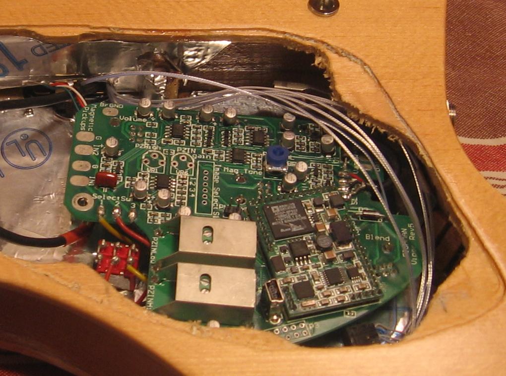

On this circuit-board there are 5 pin-holes that say "image" on near them...
Also there is a USB plug... Is there a way to change the Acoustic sound?

In a conversation with John B some time back I asked about the mini USB and he said it was a Fishman Factory thing to test the circuit board and they (Mother) didn't do any loading or unloading.
If you learned conversational Electrical Engineer you could possibly call the makers of the circuit board. I bet there's a lot of ways to hook up and screw up the programming. Since they are not making updated VXT boards the questions are moot. With a little redesign I bet it could have an awesome line up of iPod Apps to run with.

Location: Upper Left USA | Here's the CB placed in the HBVXTBW...

Location: Utah | I'm going to guess a bad solder joint on the pot as a first thing to check. It would be easy to fix - just touch it with a solder iron until the joint remelts. A burnt out component on the circuit board would not likely be intermittent, though a bad solder joint on the board is possible. A broken wire is also a possibility.
Can you tell if the tone control is the typical electric guitar configuration of a capacitor soldered directly to the pot terminals, or is the pot wired into the circuit board? |
I am not positive, but I believe that I saw on a video of them assembling them that all the controls (except for the pickup selector switch) are part of the circuit board.
The volume, tone and blend switch are on the board.
If you look at MWoody's pic of the board you can read those names on the back of the board.

Those little integrated circuits on the board could be static sensitive. Even static you can't feel is enough to zap and kill the electronics. So you have to be careful poking around. Ideally you would ground yourself to the guitar before touching anything. Holding one finger firmly onto the output jack would work. And don't squirm around on the seat you're sitting on or rub your feet on the carpet.
If there are lugs from the tone pot soldered directly to the board there is a good chance one of the solder joints is cracked. You could use something like a wooden tongue depressor or a non-static producing object (don't use plastic or rubber) to press on and around the where the lug solders to the board to see if it makes a difference.
Touching up a solder joint is pretty easy. Get the iron really hot, touch a very small bit of solder to the tip to coat it very lightly with molten solder, then touch the solder joint for a few seconds. Only until you see it get shiny, which means it melted. Then remove the soldering iron and let the solder solidify. Don't let anything move until the solder is solid for at least a few seconds.
Be sure to use good anti-static procedures when soldering. I will unplug my soldering iron just before touching the circuitry because I don't know how well my iron is grounded, but that may be overkill. Definitely ground yourself to the guitar before touching the tip of the iron to the circuit.

Sorry I couldn't chime in earlier, I finally got a chance to pull out my VXT to see if I could offer any advice. The controls on the VXT are somewhat unusual, so here's some considerations:
The tone control does not effect the Fishman pickup at all, it's only for the the humbuckers. If you set the "pickup blend control" (the one closest to the 1/4" jack) on "1", then you are hearing only the Fishman "acoustic" pickup, therefore the tone control will have no effect. Conversely, if you set the blend knob on "10" so you are hearing only the humbuckers, then you should clearly hear the difference in tone when turning the tone knob.
Here's a control summary: The switch is only for selecting the humbuckers (Neck/Both/Bridge.) The volume knob adjusts the overall volume of ALL pickups, (including the Fishman.) The tone knob is ONLY for the humbuckers. The third (blend) knob controls the mix of the humbuckers and the acoustic pup. The lower the # you set the blend knob, the more you hear the acoustic pup versus the humbuckers and therefore, the less you will notice any effect from the tone knob.
If you are adjusting the tone knob with the blend on "10" and still not hearing any difference, then you may have to try some of the other things discussed above.
As for your other questions; your photos of the pickup and knob heights appear to be identical to mine, and I believe they are set-up correctly. As far as I know, there is no internal way to "change the acoustic sound" nor add other acoustic images (although that would be interesting.) I can't easily pull the knobs off of mine either, but if I really needed to, I would protect the finish with a soft cloth and then use a thin tool inserted under the knob, but above the washer, to gently pry them up rather than just yanking on them from above. (Proceed at your own risk.)
