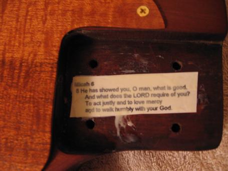

Would You, Could You, and Should You, (ever) Glue a Bolt-on Neck?
(in a car, with a jar, full of jam, Sam I am?)
I heard/read somewhere that it would increase or improve the tone.
Also they were saying to put a piece of paper in there to facilitate getting it back apart at a later date.
Just curious... Should I be inclined to deconstruct any of my guitars.

Gluing a bolt on... or some people just say "set neck". Ok there is a slight difference, but Ovation I think had the right idea with the little piece of newsprint.
The PF-22's took it a step further with replacing the neck bolts with dowels to insure alignment, and then gluing the necks and finishing (sanding) to look as much like one piece as possible.

Yes, at the factory they used white glue and newsprint. I've glued in some scriptures and even a pice of a Dilbert cartoon... it is the fibre that matters.

The theory is that sound looses energy when it moves between disimilar materials (like the air in the gap between neck and body) - so a little wood fiber and white glue acts to make it one.
When you take a neck off the body you might have to give it a little force but it doesn't take much. When you glue only cover the rectangle area between the bolts.

If you put paper in between the glue joint the theory is that the paper separates before the glue and it comes apart eassier. It does too. It also makes a more solid joint and better sound transference. Great idea.
Using scripture to do this? Well It's probably good use of a bible other than a dust collector, BUT Black Sabbath and other tunes like that will play out of tune.
If I bought that guitar and then took off the neck and saw that I'd be a little put off by it. Just like it pist me off when a guy doing work on one of my Nationals wrote "George Bush sucks donkey dicks" on an inside brace. I found it a year later doing some other work on the gitar.

Yup, the paper separates first... regardless of what is written on it.
