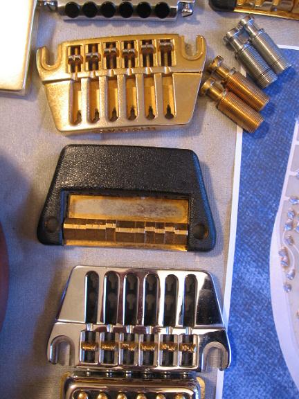

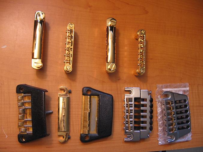

There a couple of choices of original type bridges.
Similar to what you have but with the gold metal saddles and then the all metal later Schaller bridge

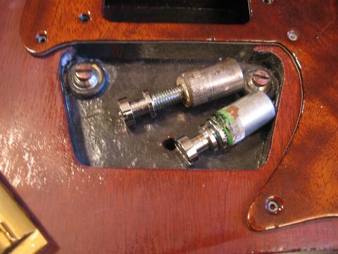

sustain issues can be a result of a number of factors. grooved and worn nut, grooved and worn saddles, break angle at the saddle, and loose connection at the neck, your BW has the oldest type of bridge/saddle combination with the nylon saddles.
also when Ovation assembled these guitars the neck was not only set in with the screw tension via the #10 machine screws and neckplate, they also glued the necks in with a piece of paper floated in the glue, the combination of screwed and glued helped with the sonic transfer from the neck to the body of the guitar. so if your guitar was re-assembled or if the neck has been removed you might want to glue it in as well.
the newer style Bridges had Brass saddles, and the newest version were cast and plated brass, I would think that you would get better sustain from the newer style bridges.

- Re-fasten the neck with the fore mentioned white glue and paper - a small area between the bolts. I like to place a scripture in there myself.
- Change out to the Schaller one-piece Bridge and make sure that your threaded posts and sockets are tight. If they aren't you may want to reset them so that they are "TIGHT"!

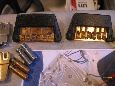

A simple mid-step is to just upgrade the saddles or get a brass bridge. The newer Schaller style is fine, but the same bridge you have with brass saddles instead of nylon is my favorite.
The nylon saddles seem to work much better on the Breadwinners with the large single coil pickups and the pre-amp. That combination works. OTher than that, the brass saddles is the way to go.

NO, don't do that! There are original metal saddle bridges available, and that is what I would put on. Besides, the body is routed and drilled for the original bridge and I doubt another brand or style would cover it up.
Is your bridge at the correct angle? Is the bridge hardware attached to the body properly? Are the nut slots the correct width (not tight, but not loose)? Is the neck tightly attached to the body? Are the tuners snugly attached to the headstock? Are the strings new and of decent quality? How about the electronics? Are the pots, switches, and capacitors proper for the pickups?

Some Gibson style one piece bridges actually do fit but yours isn't really broken yet so why do it.

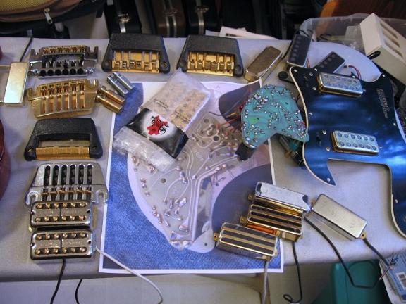

I am in possession of some parts and what looks to be a repairable BW/Deacon/PD active board and may be able to "renovate" your Breadweiner.

Let me confuse things a little more by adding some options. But with yours, you need to restore it.
