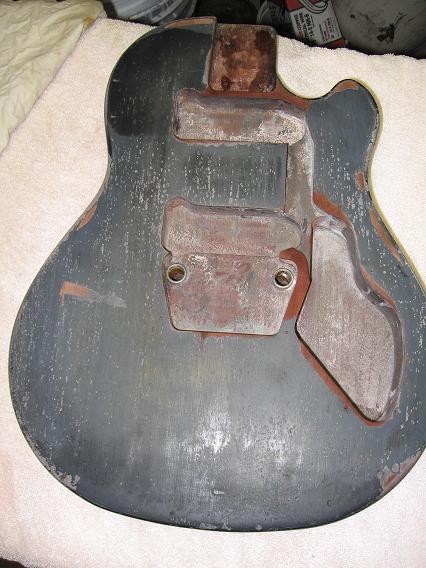

I have been trying to chemically peal the paint from a Mahogany viper body that was coated in translucent black (barnboard plus?).
It just ain't coming off! I am using the Aircraft paint remover that has removed all of the other project coatings with 30 year old poly finishes.
A Heat Gun is next and eventually sandin although I wanted to remove as little wood as possible.
Anyone have this much trouble or have some insight?
Steve

Posted 2006-07-03 4:22 PM (#248735 - in reply to #248729)
Subject: Re: Thick paint?
"if y'got this crap on your skin, it'd start burning it immediately."
It's the same or close to it. That's what surprises me because it smell bad, it burns but its not pealing!
9151 Kleen-strip Remover GAR343
I just printed the MSDS and I think I'll add a face shield to the gloves and ventilation I use.

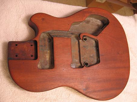

Posted 2006-07-04 11:34 AM (#248744 - in reply to #248729)
Jeff, you got a head cold?
I will push on with 150 grit and a chicken plucker for the edges.

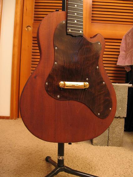

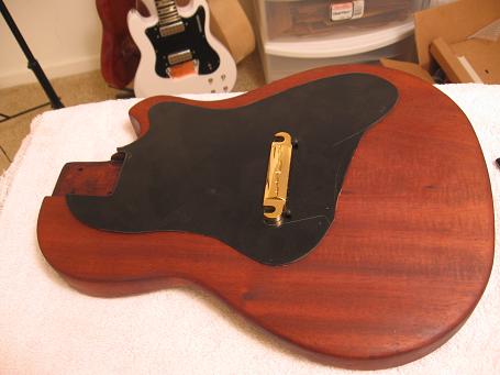

Posted 2006-07-06 12:17 AM (#248748 - in reply to #248729)
Before
After
Possible PG's
mtnbikerfred
Posted 2006-07-06 2:45 AM (#248749 - in reply to #248729)
Posts: 1421
:eek: Nice work Bro!! :eek:
I like the black against the mohagany...
Posted 2006-07-06 2:53 AM (#248750 - in reply to #248729)
Yep, I agree with Fred. That black PG looks really sharp against the grain.

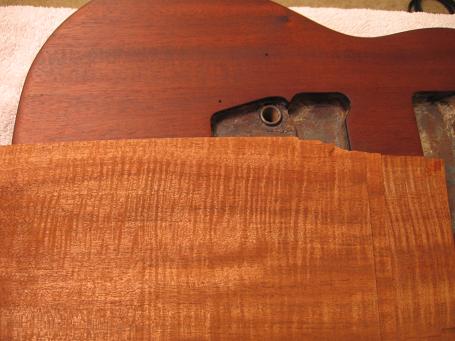

Posted 2006-07-06 10:56 AM (#248751 - in reply to #248729)
But it's plastic! Who uses plastic on guitars?
The unfinished veneers do look pretty light in comparison. I'll try some stain and a couple of finish options. Black or Tourtise would be my non woody options.
I found out a couple of weeks ago that Tom Jones, maker of the T.V. Jones pickups is just 20 miles away in Poulsbo WA.
T V Jones
I asked about what pickups to use and if they have Factory Tours - He said call and make an appointment!

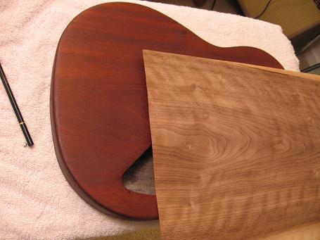

Posted 2006-07-06 1:27 PM (#248752 - in reply to #248729)
If you want wood, then maybe a black walnut.
Posted 2006-07-10 12:16 AM (#248753 - in reply to #248729)
Its Walnut and its dark!
