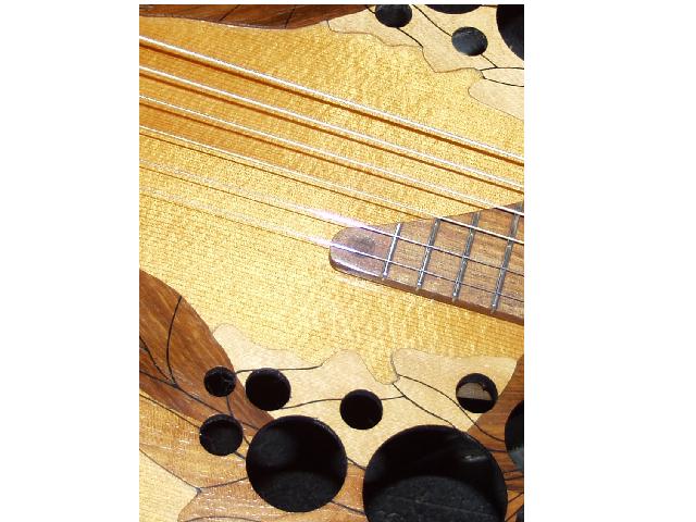

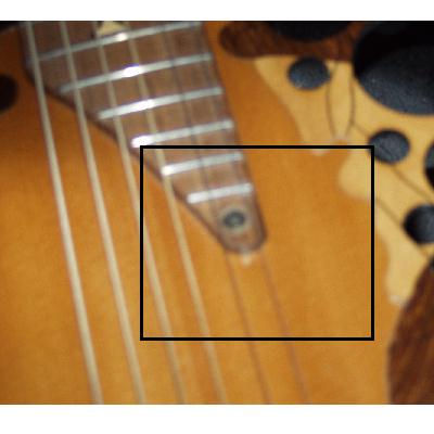

Just got in a 1537 that plays well...however, check out the "repair" (not disclosed):
Posted 2004-10-09 5:01 PM (#176329 - in reply to #176328)
Subject: Re: How not to repair a guitar
Interesting! An Ovation with Taylor neck. Cosmetically that sucks, but I doubt that it effects the sound. Maybe paint the screwhead brown to make it less noticable.
Posted 2004-10-09 5:06 PM (#176330 - in reply to #176328)
or maybe an inlaid saying "I got screwed"
Posted 2004-10-09 5:37 PM (#176331 - in reply to #176328)
I don't think that the structure is very compromised so it should be fine. Is there an inlay or is it just the skrew head?

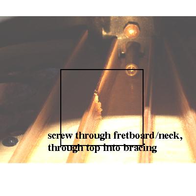

What were they trying to do? Glue the end of the fretboard to the top? With a screw thru the board, neck, top and brace?
How stupid can you be?
I think who did this needs to get a long screw up their ass!

the wood screw...definately reduced the value, if not the condition. one of the OFC members said it had a floating neck...no longer.

Since it was undisclosed and not an appropriate repair you have the right to return it. It really was ham handed. My common sense says that, the fret board should be easy to fix, and the hole in the top, if small shouldn't be a problem either, however, the support strut is a dicer issue. Consult your local luthier.

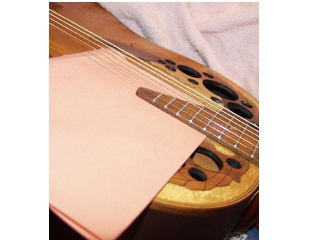

This isn't that big a deal. Return it if you like. If not, try this. When you sight down the fret board is there a dropoff where it meets the body from this being screwed down? I would guess there is. Take the screw out and allow the fretboard to go back to being straight from first to last fret. Figure out how much space there is betweeb the bottom of the f/b and the top and get/make a washer that thinckness and put the screw back in. This way the f/b is anchored, the upper notes will sound better and the top should be more free to vibrate. Put some sort of inlay over it, restrign and play for many years changing strings and battery as required.

Bill, good idea. However, last night I removed the screw and the neck came up...appears to have been no reason for the original "repair." Not sure if the neck will return to the original position or what the clearance specs should be.
the 2 adamas i have have a floating fretboard over the top too bill. i thought this helped the top to vibrate more freely. as soon as i finish my coffee, i'll get out the sheet rock screws and cordless drill.

cost to replace the fretboard/neck is more than the guitar...
so, current status:
after removal of the screw, 3/32nd (top to bass E) at 14th fret...
plug using shavings of walnut and glue; will attempt to use thin cut of walnut to match grain...

Yes it is supposed to float over the top but since design reality has proved that those notes from an unsupported fingerboard don't sound very full.(small point) Sometimes these fingerboards would warp up, lift, so I was thinking that may have been why it was screwd down. Just going with a single point screw would leave most of that area to vibrate but keep the f/b stable. Soon after this all elites had the f/b bonded on. My 84 C-Series is all glued and I think pretty much all guitars after this time were. Splitting hairs if you can hear the sound difference. You can hear those notes being fuller from the 14th fret up. Not that they get played all that often!
